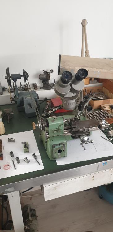

In school everyone uses loupes. I  immediately set up a microscope on my lathe once school was finished, couldn't work without it. I have Zeiss surgeon loupe glasses, but they aren't really practical. I highly recommend a simple boom mount microscope.
