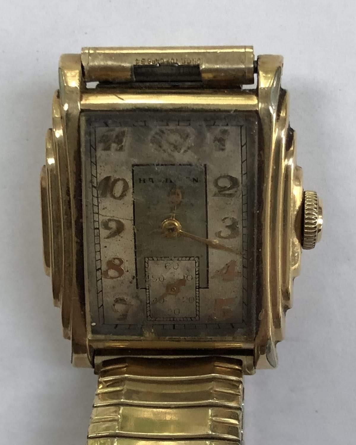

I have been working on a fine Hamilton Putnam from 1933. Everything looks good, but the hairspring is kinked. My failure rate with hairspring straightening is about 92% and I would prefer to get a balance complete, or a balance assembly, rather than ruin it. I have found that the cal. 979-F movement is either as rare as hens teeth, or are in watches which are priced prohibitively high. Does anyone know of an alternative which would work, or where to find a 979-F? I've already done numerous searches to no avail.
Ofrei will have a hairspring for 979-f for US $45...are your skills up for that?
https://www.ofrei.com/page825.html
Hamilton 979-f donors with balance complete can be had...for a price, as you say. $150US is the lowest I could find...
Borel says the 987 987E 987F are compatible, so you can search those movements as well...

Aparently its niether colleted nor studded.

5 hours ago, JohnR725 said:
I don't suppose we get a picture of the movement?
Not a very helpful comment, but thank you anyway.
I'm sorry that you don't find me very helpful. But I don't find it helpful to get numbers and not know what I'm dealing with. So that makes us even of being not helpful. except now I have a picture so I know what I'm dealing with that's helpful.
I just a note on compatibility because when you start looking for eBay you might wonder about this. Notice how the 987 is compatible but it comes in a whole bunch of variations some of which are compatible and some of which are definitely not compatible. I snipped out an image from the bestfit book it has the smaller number which is the old number and the large number which is the newer number.
then for the hairspring things get more complicated which is why a picture was required. You will note there are two separate hairspring is available for your watch. Each of the hairspring's has a description like for instance steel typically this would be a blued steel hairspring like what you have in your picture. This also goes with the bimetallic balance wheel. The other one would be a white colored hair spring for a solid balance wheel you'll notice that they're different as they do not interchange.
