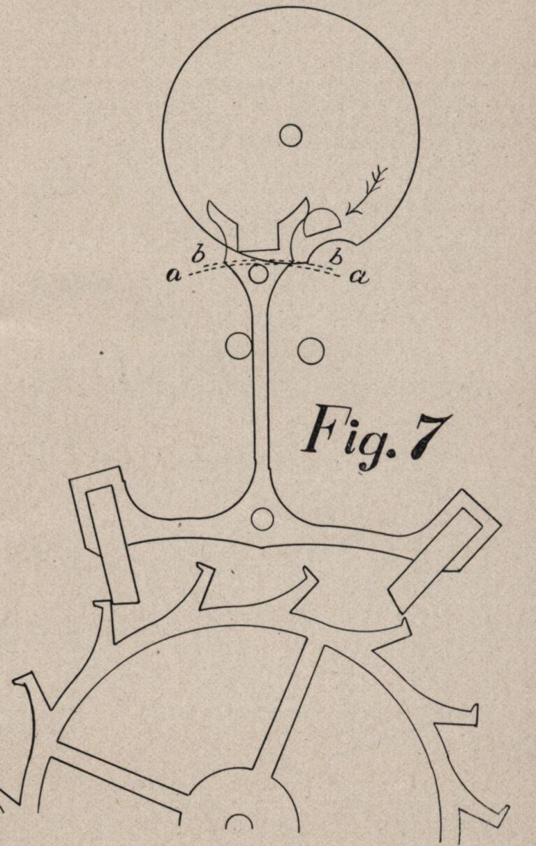

You don't think the staff has broken. One thing that might have happened because it had a fall and that is has the balance over banked. That is where the balance impulse pin is the wrong side of the pallets. Her is a photo of what I mean. If this is the problem you need to unscrew the two screws and get it back in between the pallets.
