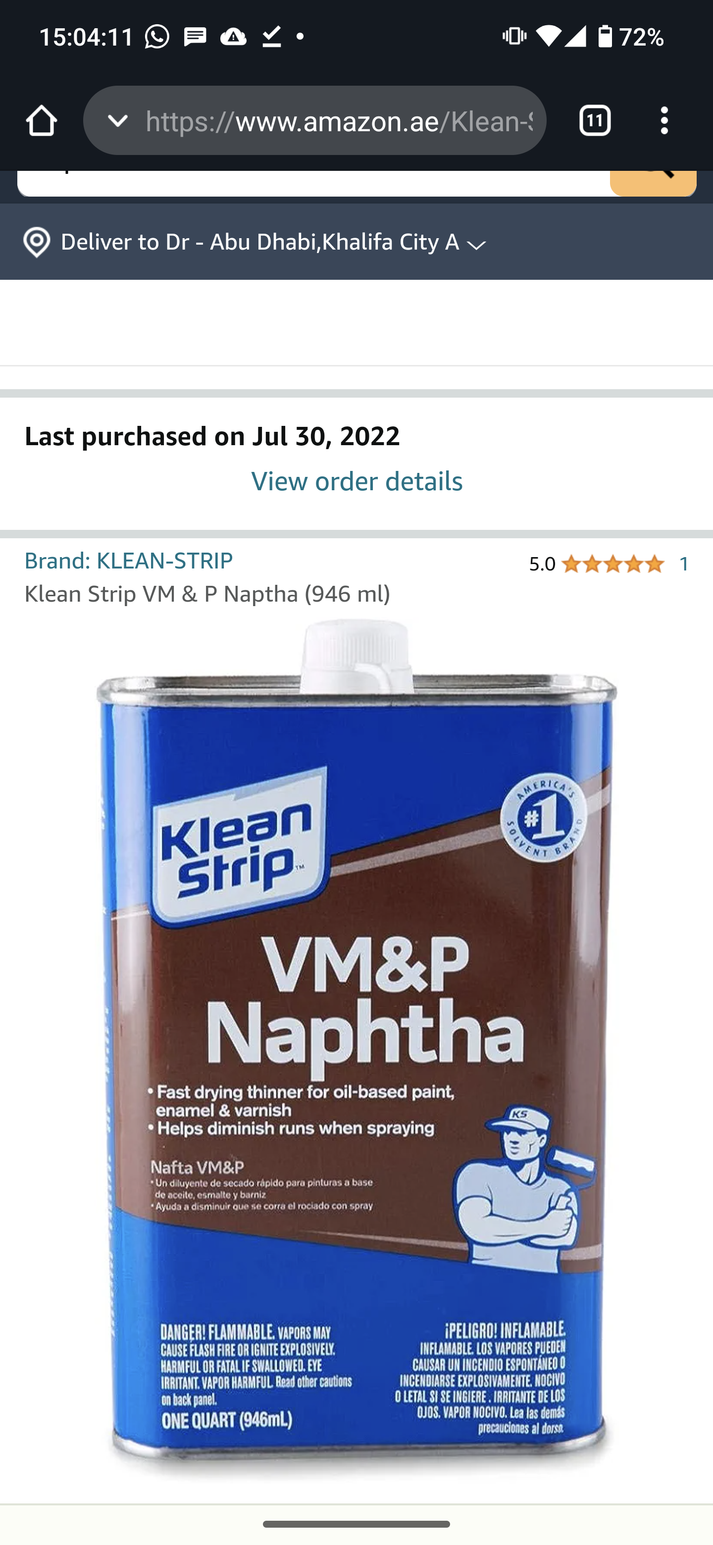

Thanks Scott. No problem buying an ultrasonic cleaner. IPA I can also get but what brand is this naphtha stuff as hopefully I can add it to my order with Cousins?
I use the following, but mainly due to where I live
You may get some people advising to use zippo or similar lighter fluid, but lighter fluid is just naphtha, so get this stuff for a fraction of the cost of a little tin of zippo lighter fluid.
