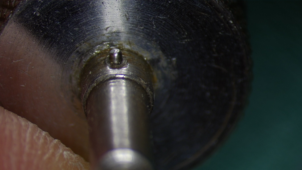

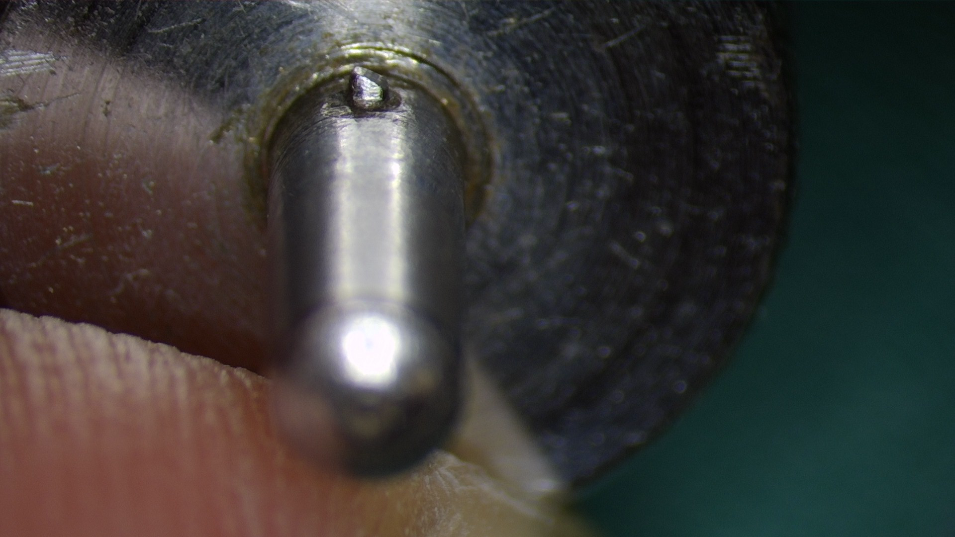

I've had a couple of these adjustable winders of different sizes for a while. I thought they were useless but I encountered a problem so I decided to give them a one more go. So the problem. Seiko 5606 barrel is just a bit too small for Bergeon #7 and #6 is too small so that the mainspring gets packet way too tight. The pins in the adjustable winder are symmetric. If you manage to wind the spring, there's no way getting the spring unhooked. That probably has to do with incorrect size/pin protruting too far. I filed one side of the pin sloped so you can get the spring unhooked while turning backwards. I haven't even had any trouble with the automatic bridle. Really great once you figure it out and have a winder with proper arbor/hook size. I originally bought these when I saw Spencer Klein use one. I think he still uses them.
1.thumb.png.ad26040be49b1ca168f8979fa56d8564.pngK&D winder
2.thumb.png.86abddd1641efffe38e6e67de5277c51.png This is how the opposite side still looks.
I filed this pin on one side to be able to unhook the spring. It's like Bergeon right handed now.

I have the set of 3 and use them regularly. I haven't touched the hooks on mine so they still wind both ways, up to now the hook has always backed out for me. It should be possible to get inside with a bent pin to pull the spring out just far enough at the back of the hook to release it and back it out.
