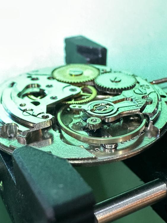

I am working on a watch with an ETA 2452 movement I bought on eBay.  When I got it the crown was stiff and it would only run for a couple of seconds after a good shake.

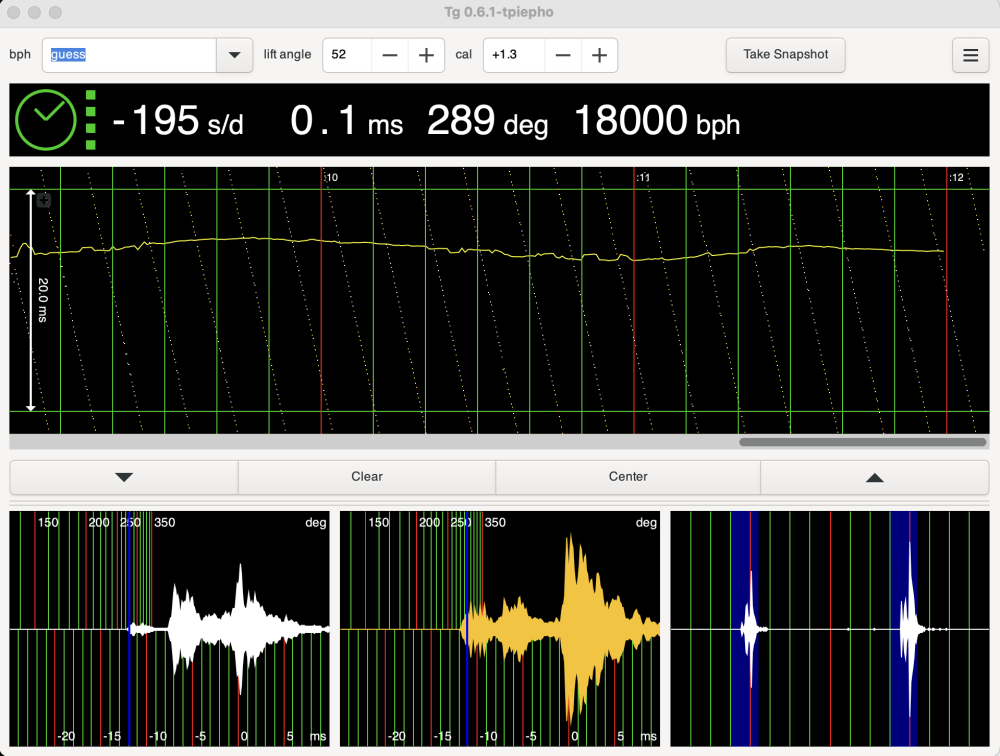

I have disassembled, inspected, cleaned, reassembled, lubricated, demagnetised.  It runs and I can regulate away any beat error but even with the regulator arm all the way across I can't get the watch to run fast enough.  It has a respectable amplitude and gives similar results in all 6 positions (slightly lower amplitude when not dial up or down).
The hairspring looks in great condition to me
Any ideas?

Assuming that you have carried out the checks outlined above by @nickelsilver one thing to note on these ETA's (and others) is that the regulator offers both coarse and fine adjustment.
The end with the graduations is the fine adjustment, but you will find that the other (boot) end can be moved independently.
I would center the fine adjustment end and then gently nudge the boot end until I got it as close to where I wanted it to be on the timgrapher, then fine tune with the graduated end.

I have checked and the hairspring passes nicely through the gap between the boot and the pin
And yes I have seen  movements where you can do that (the ST36 I bought to learn on for example) - but this isn't one of them. On this movement the boot end is on the same piece of metal as the pointer to the graduations.
I have done a little googling and found  some variety in the balance between different ETA 2452 movements - some have wheels with adjustable weights some have corse and fine tuning while mine seems to be very simple...

How big is the gap between the boot and pin? Should be just a little over the hairspring thickness.
Pretty small - here is a photo (very hard to show!). But I don't think this is the problem as I can make the watch much slower by moving the regulator in the other direction

So its likely to be what you said, balance and hairspring aren't matched, which if is the case,
Unpin the hairspring from the stud.
Thread  about the length of the  current terminal curve through the stud.
Repin.
Turn the H/S collet to bring the balance complete in beat.
Regulate.

Heres a pic of boot and pin.
Turn the boot to align with the pin so  hairspring can't jump out as it breaths.

My research has shown that this can be down to the hairspring effectively being too short due to magnetism or the coils touching as the hairspring breathes.
Try a demagnetiser and check to see the hair spring is even and flat

your timer - indicated 18000 bph
ETA 2412 actually runs at 21,600 - do not trust the auto settings
I'm confused....
Yes, the ETA 2412 does run at 21600...
But aren't we talking about the ETA 2452 here?
