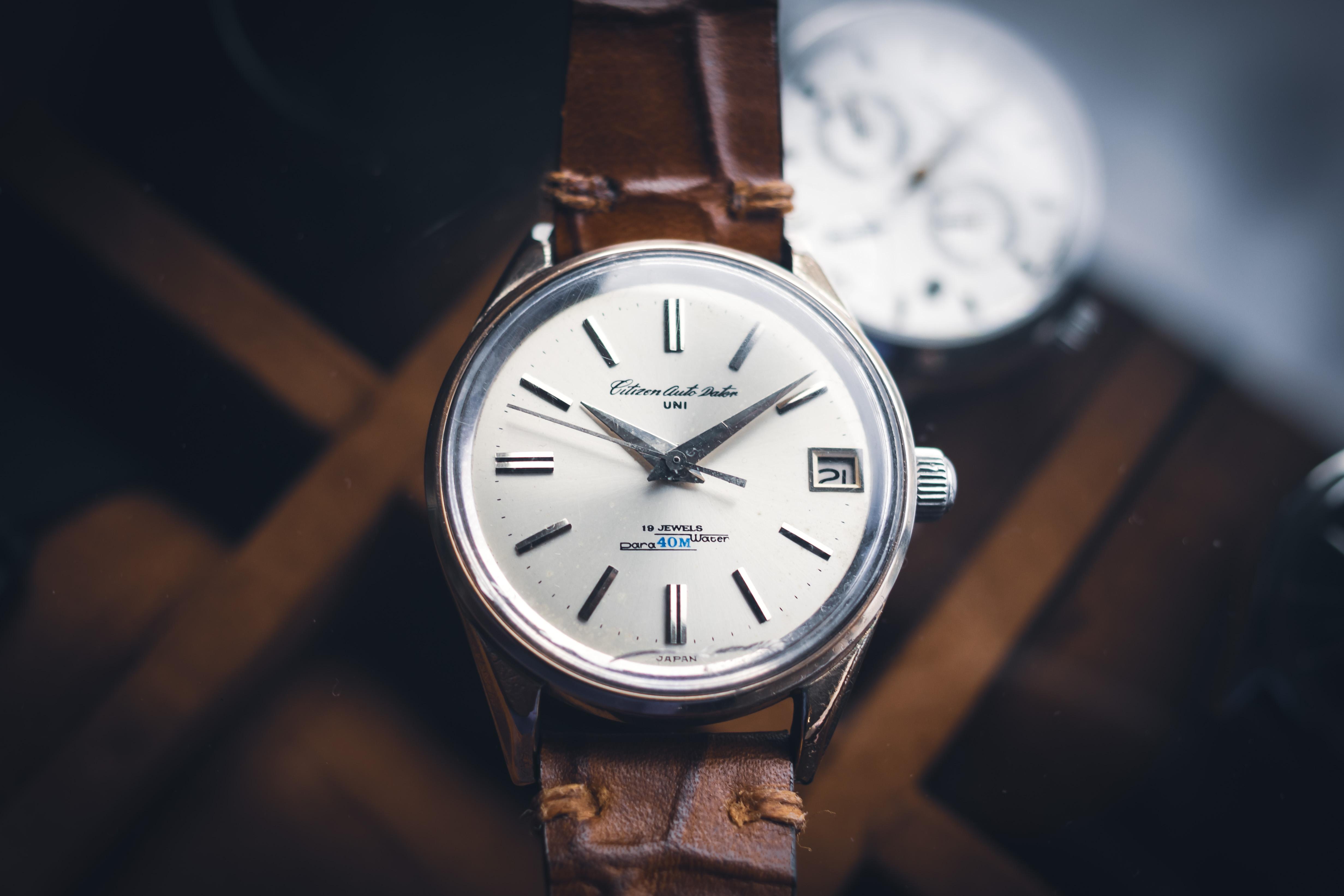

Since my last post about an Omega and a Seiko, I have fallen deeper and deeper into the buying vintage watches and cleaning the putting-back-together hole.
So I picked up this guy from one of the auction sites for about $10
I stripped everything down, cleaned everything, and tried to put it all back together. Seems everything went well I am however stuck at the calendar wheel and spring.
Seems the last guy that came in here lost the spring and made one of those guitar string type spring. I know that it works as I tested it before I took things apart. Only thing is it does not sit flush and its a juggling affair to get the spring to sit pushing on the calendar lever sitting just so the date wheel without flying into space. Then only I can put this plate on.
As far as I can tell, the plate is what is holding this precarious spring lever date wheel sandwich all in its place.
I can take it apart, I am amazed at the previous guy to get it all in just so.
Can I get any advice on how I can get this done?

Do you know the calibre of the movement. You can do a search on YouTube to check for any assembly videos of the same calibre or calibre from the same family.
Your date detent spring looks distorted. You can try making your own by bending guitar wire. It's not difficult but you'll need a pair of good round nosed pliers.

The spring is definitely distorted. I think the last guy in this movement replaced it with a guitar wire. I recognize it as I have done it multiple times. I only have no idea how to secure this in the right position before putting on the plate.
Good idea about looking up the movement. The movement seems to be called the 2400.
So even with a correct date jumper spring, I have no idea this could stay in place before the plate goes on.Screenshot2023-09-09at2_58_35PM.thumb.png.bc130f273ec3b8d44c5c342949476635.png

I think I do not have enough hands the dexterity to do it. I cannot imagine the spring behaving itself and not flying into space.

If you are worried about losing the spring, a popular trick to try is to place the watch a clear plastic bag and work from inside that.  Its fiddly until you develop a technique but greatly reduces the chances of  spring loss.

This is a very common configuration for a date jumper spring. And it is one of the better ones. The worst I've worked on has to be the Russian Slava 2414. The date jumper and spring have to be mounted on the underside of the calendar cover plate, then turned over and put into position and screwed down. The slightest knock would launch the date jumper across the room.
So Sunday is try to play with springs day. Suffice to say I ended on my knees for a few hours try to find said spring and its neighbouring parts. Magic wipe did help me to find it. I will try it again next weekend. How did everyone elses weekend go? Better I hope.
I have however popped everything back in excluding the spring and put it on my wrist because instant gratification. I will work on the spring again next week.
