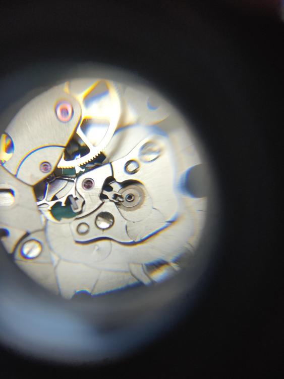

Hello everyone, I'm almost done with this mechanism. I'm trying to restore fathers seastar tissot. There're no official parts for it so I'm bying new and new watches and non original parts. Now after collecting all of them balance is not running.
I disassembled it, it was not glued at the tip. Glued it and barely regulated the hairspring. But it's still not running at all.
Help me please with any advice

Are the top balance jewel and spring sitting properly? It's hard to see as the pic is out of focus.
Not sure if it's just the photo but the pallet fork where the impulse jewel connects looks bent.

I'm not sure about the pallet fork but it works. When I push the balance wheel it give power to the fork. But it's not running by itself
Well i'm sure about the jewel, but this spring makes me sad. Something might be not okey with.

With no power on the mainspring, give the balance a good blast with a puffer and see how long it oscillates - should be over 30s
Oh okey, and if it'll be less than 30s the problem is in balance ?

That's a problem. Remove the pallet and see how freely the balance moves. The balance may have the wrong pivots sizes for the jewel holes, or a bent pivot.

No it doesn't. The coils should be evenly spaced, not bunched up, and the terminal curve is not between the curb pins (yellow circle)
My bad I should have noticed that terminal curve is not in place, now i can say that balance is moving for 19 seconds. It lost almost his speed at 8 second of running after a blew there with air

And its snapping nicely from side to side when you touch it ? You definitely have an issue with the hairspring but its good to check the other side of the escapement as well. We all do things differently,  i consider the train side of the escapement a little easier to check. Mainly as its the start of the assembly and checking as you go. The balance and escape problems can be multiple and a bugger to find if they aren't glaringly obvious.
Haha poor lad , hes getting it from both sides, me the pallet fork , mike the balance. Feel free to join in Rich , 3 of us can cause even more confusion 🤣
Ahhaha really I'm so bored with this watch, this eta 2846 is a piece of scum
Yoy men this sht is moving! I can't believe it. I'll check the accuracy of moving and text back
