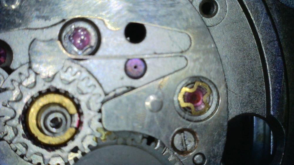

I took the bridge and pallet off, took some pictures of the jeweled pivot hole on both sides of the plate and made a video to show the power going through the train.

Looks like the bottom pivot has hightailed it.

Can you improve the clarity of the photo, or spin the fork over and take another photo, ww is right we can't tell for sure if the pivot is there . Once thats been established you can move on. You have two forks i remember so we need to see clearly all 4 of the pivots.

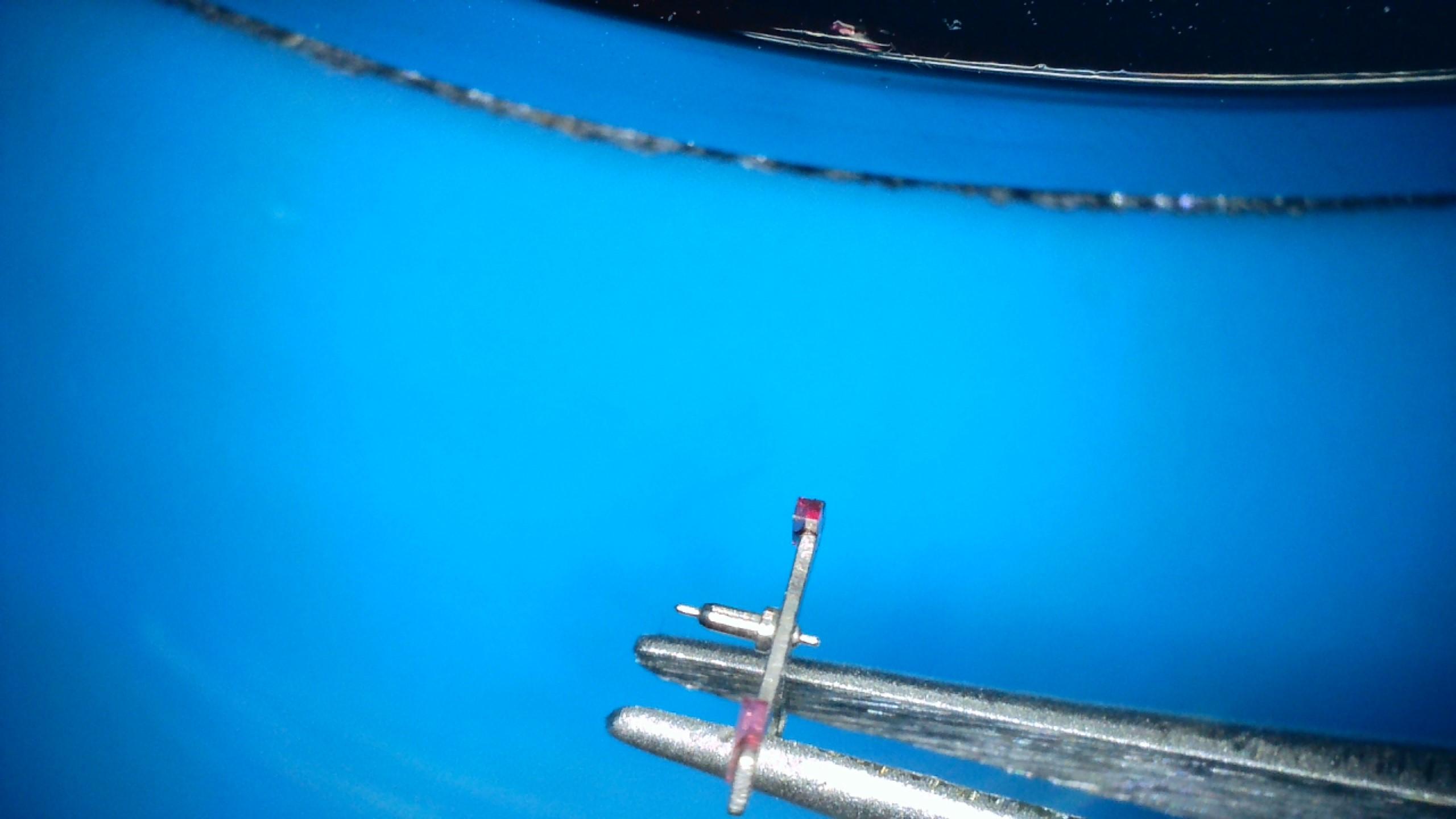

The first 3 photos are from the spare pallet. The last 3 are from the current installed pallet.

Thank you for the clearer photos, if you think all the pivots are there then its time to see why the pallet fork is not staying seated between the pallet pivot jewels. I would suggest mounting up the pallet fork without the balance or escape wheel and then check for how much endshake you have between the jewels.

According to my research, the pallet fork is Seiko part 301611 and by googling some images, it has a short pivot and a long pivot.
Right having proved the pivots  are as intended. One short one long and both intact, remove every thing from the plate and install only the pallet and the bridge and re check the fitting,  both end shake and side shake,  and if it still wobbles when fitted.  Close ups of the fitted position from top bottom and side.

So yas, now that it appears you have two forks with two asymmetric but maybe correct pivots, back to this pic where it looks like the fork may not seated properly, hence the call for jewel inspection and an examination of the fork in place by itself, a check of end shake then division, then with the escape wheel back in place and do the pallet jewels and escape wheel play nice?
…and then we’ve been focusing on the pallet fork but from this picture I can’t see a pivot for the escape wheel seated in the upper jewel, so even though you say the train has good power without the fork perhaps the escape wheel isn’t seated correctly or an issue with endshake or division or an issue with the escape wheel jewels and is there a cap jewel for the escape wheel shock setting upper and lower and does that raise/lower the escape wheel so it plays nice with the pallet fork? ...and yes I see from the photos you have cap jewels so without the cap jewels are the escape wheel pivots seated properly in their respective pivot holes and sitting neither too high or low?

Fork appear to be touching its bridge, bridge might pressing on the fork thus might have bent the pivot.

The pallet stones look to be riding ABOVE the escape wheel, the interaction between the two doesn't seem right. It's time we had a clear picture from the side, strip everything back leaving just the pallet fork and eacape wheel installed.

Hi  NEW is on the right track, given the last picture where the pallet is riding over the escape wheel suggests that the pallets are not fitttet to the arbour correctly and need re seating on to the hub to bring them inline. But looking at the pictures of the pallets in the rweezers it looks to be ok. I wonder if the staff has been replaced and it was put on upside down.  I would be inclined at this time just to fit the pallet and the escape wheel to the plate and check out the alignment between the pallets and the wheel, and a picture from the side so we can all see how it lies because somthing is definitely out of line.

Isn't this picture interesting yes the pallet stone appears to be out of alignment with the escape wheel but notice I circled something it appears to be that pallet fork might be a little high as it's touching the bridge?
Let's look at the images the two separate pallet forks and who knows which one is in the watch but I'm guessing the second one.
In the upper image you can see the pivot and a bit of the arbor sticking up. In the image down below we just have a pivot and well at least give a pivot it's not like we really need clearance here is it?

Now let's swipe an image off eBay they claim it's the right pallet fork and see how it looks? Definitely looks better looks like more of the arbors sticking up like it's supposed to be definitely give you better clearance.
