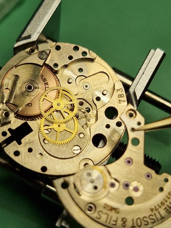

Hello everyone,
I just started working on a Tissot 783 (inside a Seastar Automatic from the 1960s).
I really like the direct centre seconds construction, avoiding those annoying seconds pinion springs. Overall, I must say, nice movement!
I'm wondering about two things:
1. The mainspring barrel is engraved with "do not open, greaseless". I noticed, before opening, that manual winding effectively wound the movement (getting to very good amplitude despite the last service being 10 years ago) BUT I could not hear any slipping of the mainspring. No sounds whatsoever. Just smooth winding sounds. Now, I have three options for the service:
A) Just reuse the old barrel complete without opening it.
B) Order a NOS barrel complete (but noting that this is probably several decades old). Price is reasonable at 35 USD.
C) Open the barrel anyway, replace the mainspring with a new one (GR2922X) and use breaking grease as usual.
2. Any advice or technical sheet available on how to lubricate the automatic works?
3. Do you know whether there should be a dial washer? There was none.
20231011_101648.thumb.jpg.67b03cf3dddb417e92264895708543d6.jpg20231011_101941.thumb.jpg.782e2480f5876d276a99ca7767185815.jpg20231011_095440.thumb.jpg.cd46cbfcd74ecc891230f69273080c7b.jpg20231011_092949.thumb.jpg.ef528328f2f20ad76fae11bfeb71dcec.jpg20231011_092036.thumb.jpg.1dddc47c46edf7f68c188697b9da8754.jpg20231009_224755.thumb.jpg.8b80fc182630cf42e8663853cdda07d5.jpg20231009_224925.thumb.jpg.aa1d5dba21005701629c4227632fc3fd.jpg
I would be careful, I think i opened a Tissot barrel like this but the barrel was crimped over the cap to secure it in place, so when I came to put it back together it wouldn't snap in place like a regular barrel. Cost me more than I paid for the watch for a new barrel and mainspring set.
Have a very close look under magnification to see if you have a crimped barrel design. If in doubt leave it well alone.

I would choose a new option "D" - open the barrel, clean and inspect the mainspring. There's a good chance it's OK to re-use
Thanks for that added input to my decision fatigue 😅. I don't have a mainspring winder, so I never really follow that approach.
I agree. I won't take that risk unless I have an NOS barrel complete already lined up.
I am thinking that I should go with the NOS barrel. Since it says "greaseless", I won't have to worry about old oil/grease, right? I can get one for 30 USD (incl shipping) in the sealed original Tissot packaging.
That's the easy option. You just don't know how old the grease is.
Normally if this wasn't an automatic barrel it wouldn't be a problem at all. So basically the only grease is found for the breaking feature and if the watch seems to wind up runs 24 hours seems to have reasonable amplitude then? As this is a personal watch versus you're doing a commercial watch we could assume it's fine if it started being a problem well then you'd have to replace it. With then the problem also being despair conceivably might have the same problem. If you are doing this for a customer who paid a lot of money or paid any money at all then well I'll watchmakers who won't even touch a watch unless I can change the mainspring.
Is it at all possible that the "Greaseless - Do not open" barrel doesn't have breaking grease and that the slipping of the mainspring is achieved differently/without grease?
If there is breaking grease, I'd have my doubts about purchasing a 50+ year old barrel complete where the breaking grease has probably deteriorated.
Amplitude was good (270, dial up) at full manual wind. But I didn't test power reserve.
I want to treat the watches "professionally" and therefore I feel that I must change the mainspring

As JohnR725 says, if it's a watch for a customer, fit a new mainspring. I used to as a matter of course. But after reading some comments from NickelSilver (who said he usually uses the old spring), I now only fit a new mainspring if the old one is badly set or broken.
Maybe I wasn't clear. There's no question here: I want to change the mainspring, I always do. BUT I was utterly confused by the "Greaseless - Do not open" inscription on the barrel. I took it literally. Particularly, I was seriously wondering if there was no breaking grease?!? I thought that, maybe, this was a very special type of mainspring or barrel.
Well, since I knew that a NOS barrel complete could be had at an acceptable price... I went ahead and opened the barrel. And it looks like any other barrel+mainspring I've seen. Also no difficulty in opening it. A picture is below.
I shall proceed as usual. Get the appropriate GR generic mainspring (GR2922X) and apply breaking grease to the barrel wall. (and of course HP1300 to the arbor like John's picture shows).
After all that "drama", I really wonder why Tissot would write this on the barrel. Only a money making move?

Good for you. But that looks a perfectly good spring to me. I've had new springs that didn't looks so good. Can you send me all your "old" mainsprings please 😀

Now that it's a part I would use 9504 on the arbor as opposed to the HP lubricant. That's only what they do for new old stock barrels that aren't opened up although even if there opened up that's what Swatch group uses. But if you're going to follow Swatch group's recommendation and you disassemble it at your now supposed to epilam various aspects of the barrel to keep the HP oil from running over inside.
Then yes you could use the old mainspring.s that was the purpose of the particular working instruction was on recycling the barrel's of everything looked perfect they just recommend wiping the spring down and putting it back in with breaking grease. But they also clean the barrel and put epilam on it. But personally I prefer a grease on the arbor which is why I use 9504
There may be a concern over watchmakers who do not understand what breaking grease is. Then I doubt it's really for money making because they don't really make money on spare parts They make money on selling complete watches.
