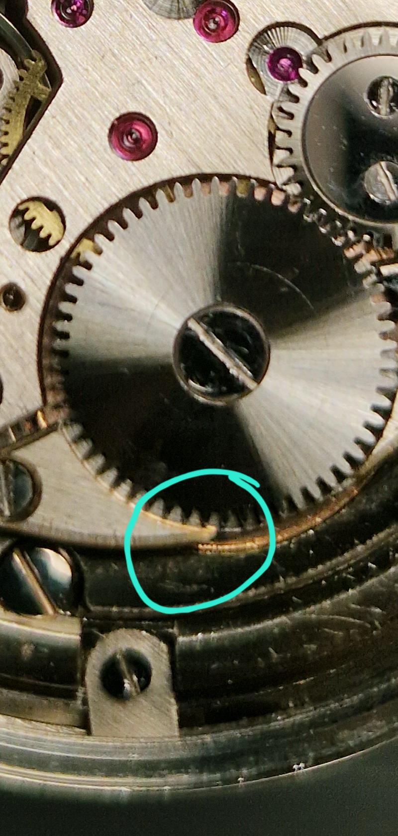

Damn, I have a problem.
I thought I was done and the watch was running nicely with 300° amplitude, but when fully wound, it suddenly stops after a few minutes of running.
I managed to find the issue, but I'm a bit perplexed by it. Sorry in advance, I don't have good pictures at hand. But let me describe:
As I (manually) wind the watch, the ratchet wheel increasingly starts to move sideways, away from the crown wheel. So much so that the ratchet wheel teeth start get stuck on the barrel bridge (the picture below shows where). Ok, so I thought that the sideshake on the barrel bridge hole is too big. But it's quite minimal (for reference, it's much less than here: https://www.watchrepairtalk.com/topic/25930-barrel-too-much-side-shake/). Furthermore, the ratchet wheel itself does not move up/down when I press down on it on its sides (toward its teeth). The barrel certainly has quite a bit (probably just too much) side shake, and the cause may also be the sideshake of the barrel (lid) itself -- I still have to check that. But I fail to understand how that could actually move the ratchet wheel so much sideways if the barrel bridge hole is (mostly) ok. Am I missing something?  Maybe the barrel bridge hole is relatively tight on most directions, but a bit oval (allowing the ratchet wheel to move, while not showing too obvious sideshake in other directions).
Disclaimer/apology: I know that this post may leave you guessing/speculating and maybe frustrated by the lack precise information/pictures. Sorry about that. I only get about one evening per week to work on my watches and when I do, I just post with the info of where I left off...
Picture: teeth get stuck on the circled edge of the bride. 20231029_193927_resized.thumb.jpg.187f05ed140b72b435d600ef33683ce4.jpg
Edited by Knebo
whohaaa, I'M SO DAMN CONFUSED NOW.
First, I was SO proud for myself tonight. I use my staking set for the first time to close holes. I reduced the size of the arbor hole in the barrel bridge as well as the bottom arbor hole in the barrel. With that, I successfully eliminated any significant sideshake. When touching the sides of the barrel, it has only minimal play. It won't touch the center wheel despite very tight clearance.  So I was absolutely delighted.
But then the shock. When reinstalling everything, the ratchet wheel still does that the same kind of move. First towards the crown wheel, then away from it until it touches and gets stuck on the opposite side on the bridge itself. Before installing the ratchet wheel, it seems pretty perfect. All wheels are spinning very nicely without any wobble.
As opposed to my earlier message above, the issue doesn't seem to be related to the amount of power /torque in the mainspring/barrel. It already occurs upon the first turn of the barrel.
I just can't explain it. What could I possibly be missing?
Only one thing I noticed is making me think: when screwing in the big flat ratchet wheel screw, I noticed that the screw was not going down nice and evenly but seemed to tilt/wobble back and forth as it went down. That could indeed be the reason. But I really don't know how I could have damaged it -- it was fine before I started the service. Have you ever experienced that?
Pictures:
As the ratchet wheel turns, it first moves very/too close to the crown wheel. 20231030_225028.thumb.jpg.cc715791c7d4033c7ea1b4b8fd012952.jpg
Then it moves away. Crown wheel and also the clock are barely engaging. 20231030_225125.thumb.jpg.05a7098c0282c7a14249a94af0979fe7.jpg
On the opposing side, the ratchet wheel teeth get stuck on the edge of the bridge.
Edit: had the idea of putting on the ratchet on the barrel/arbor without the bridge to get a better look.
It's astonishing, actually. The ratchet wheel is off center. I took the picture from exactly straight above and you can see (better in reality) that there is more distance to the edge of the barrel at the 3 o'clock position in the picture and much less in the 9 o'clock position. If you can't see it in the picture, I assure you it's true.
From the side I cannot see a tilt with the naked eye/loupe. Seems straight.
After seeing this I'm not sure I understand anything better than before. I've isolated the issue, but still not sure how this can be. Can't imagine the barrel arbor holes to be off center (both would have to be equally off center to allow for the arbor to be straight as it seems to be).
I also can't imagine the ratchet wheel to be oval...
And I don't understand how the arbor and it's screw could cause this.
Well, good night for now. Almost 3am here, brain is shutting off.
Edited by Knebo

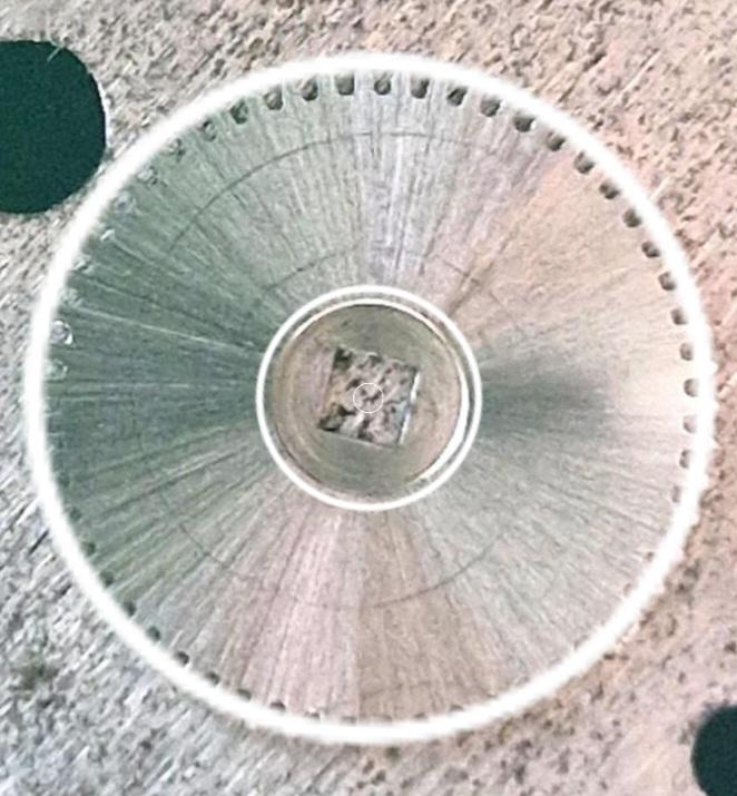

I would take a good look at that ratchet screw and the thread in the arbor.
4 hours ago, Knebo said:
The screw looks ok. But I can't look inside the arbor thread.
Does the ratchet wheel move around when you are screwing it down ?
The two circles in this picture are central to each other and to the ratchet screw. Compared to the barrel they are near as damn just a touch out top and bottom.  Now look at the ratchet wheel teeth inside the large circle, the shadowing on the left makes comparison a little difficult but there looks to a difference.  Point being we know that the teeth are not central to the barrel but the screw is. Dodgy ratchet wheel ?
Edited by Neverenoughwatches
Hmm, yes maybe. I didn't really notice it, but now that you say it...
Thank you for your effort with the circles! That's extremely helpful and confirms exactly what I observe.
Just the conclusion puzzles me. This ratchet wheel was working fine when I got the watch. I doubt that a ratchet wheel can turn oval in the ultrasonic cleaner, hahah 🫣.
I'm thinking that maybe I damaged the barrel arbor when holding it with a pin vice. That could explain the wobble of the screw and MAYBE a certain off-centered-ness of the ratchet (despite being central in the barrel holes).
I'll try to get a new arbor, and maybe a next ratchet+screw (to be safe).

Still doesn't make sense if the screw is central to barrel. I would check that with a pair of calipers and also the ratchet wheel just to make sure that isn't deformed. Take nothing for granted in watchmaking.

I took some more pictures. Could you do that magic again with the concentric circles?
Frankly, I don't manage with my caliper to mesure this properly.
However, I must say, with the bare eye, the ratchet wheel looks as if the hole wasn't in the middle. Ot would be the thing that explains everything perfectly, so I hope that's the problem. BUT how on earth does a ratchet wheel get deformed like that?

Hmm wierd. The 3 circles are central to each other. The small inner one is centered by skeg of E but it looks bang on the outer circle shows the difference in the wheel. How about removing the  mainspring so you can spin the arbor in the barrel with the ratchet wheel attached .
Thanks so much.
But sorry, I'm not sure I understand what you're writing. You agree that the wheel is not properly round, right? The two inner ones are concentric ti each other, but the outer circle is not. Is that what you're saying, too?
It's hard to determine whether the ratchet wheel is eccentric or not from a photo. There might be lens distortion or if the photo is taken a little off axis.
Do what @Neverenoughwatches said. Remove the mainspring, then reinstall the arbor and barrel cap. Put the barrel assembly back into the movement and check the meshing of the teeth.
This is so weird. I can't imagine how it's possible for the hole to drift off- center.

All the circles are concentric to each other, the outer circle shows that the ratchet wheel is not perfectly round to the hole . However i cant say for sure how accurate i have centered the first one even though the middle one looks to be ok. Mount the ratchet wheel to the arbor and barrel without the mainspring so it can spin by itself. You should be able to see any deformation.
It can only have come from the factory like this, just not possible for it to have deformed afterwards.

Ahhh we're all missing something, to add further to it was running and winding before. Maybe it was just clearing the bridge before but it hasn't just been dis and reassembled has it ? Something else must have been changed to cause this.  Knebo said that he was proud that he'd closed the arbor holes  in the mainplate and barrel bridge. Arbor hole positions shift ? Bent plate or bridge ?
Thanks all for continuing to think about this!
The problem was there BEFORE I closed the holes with my staking set. That was an attempt to fix the problem (at that point, I though the excessive side-shake was the cause). Closing the holes didn't make it worse, but also didn't help.
Also, the barrel itself seems to move nice and round without any up/down wobble (when looking into the movement sideways where center wheel and barrel teeth are meshing).
It can't be an issue from the factory though, it was running and winding before
True.
I agree.
I can literally see the wobble just by winding it half a turn (with screwdriver on the blench block). I don't have a mainspring winder so I'd have to buy another mainspring if I remove it (and this one is rather expensive). Sorry, you'll probably find that annoying if you are offering good advice and I'm not following it.
To avoid getting on your nerves any further, I'll take my chances and get a new ratchet wheel + screw and arbor. I found a good deal on eBay. We'll be smarter afterwards.
