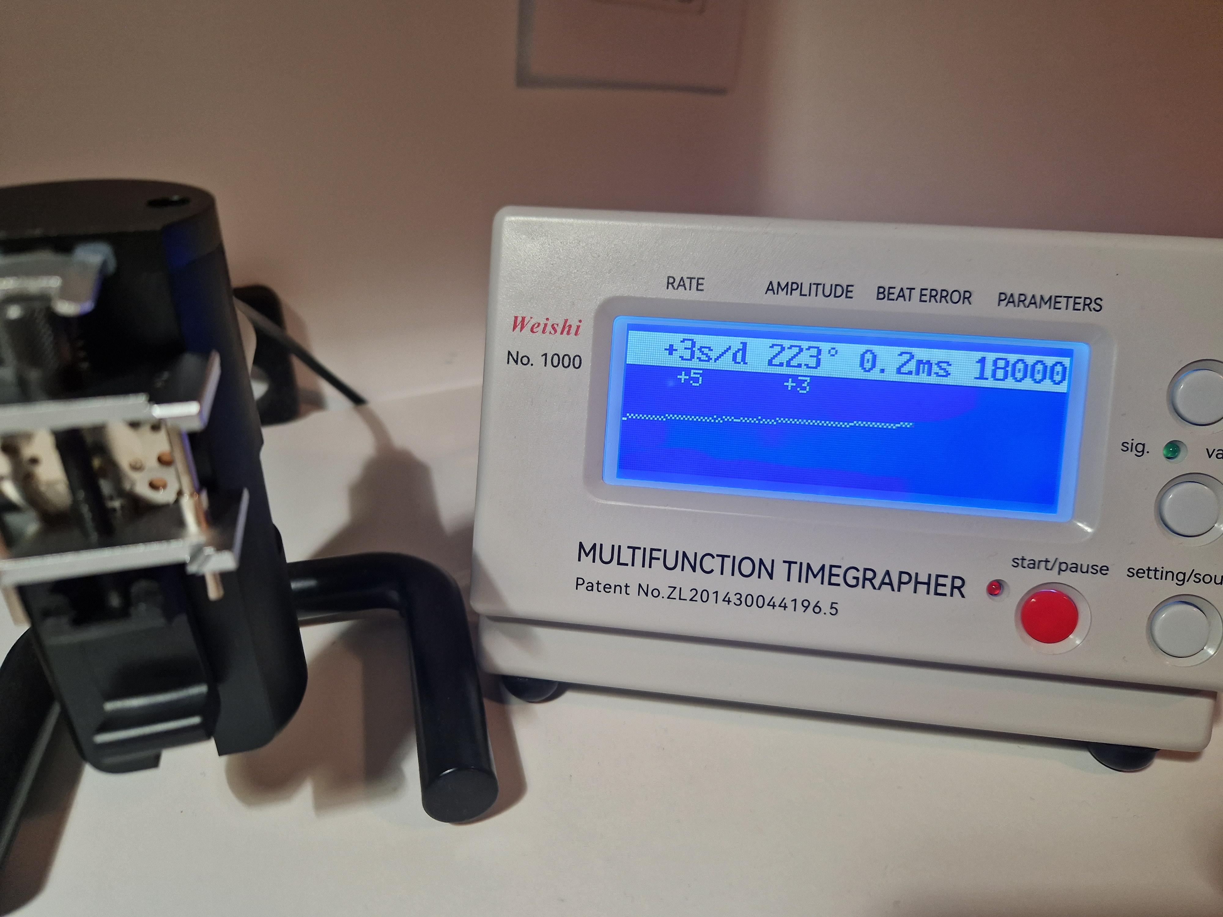

So.. good news!!
New ratchet wheel arrived and everything works just fine.
While it now definitively confirms where the problem was, we will probably never know how the ratchet wheel ended up with such a bizarre off-center hole.
I'm also very happy that the hole-closing on the bridge and barrel arbor holes seemed to have worked well. Sure, I'll only know in a few years if the repair was long-lasting, but at least for now it doesn't seem to cause any increase in friction - quite the opposite: Amplitude is very high with nice, stable traces.
Here a picture at full wind and dial up:
And before you say anything, dear @JohnR725😅, here are pictures after 24h in dial up and vertical crown down positions:
Dial up at 24h:
Crown down at 24h:
