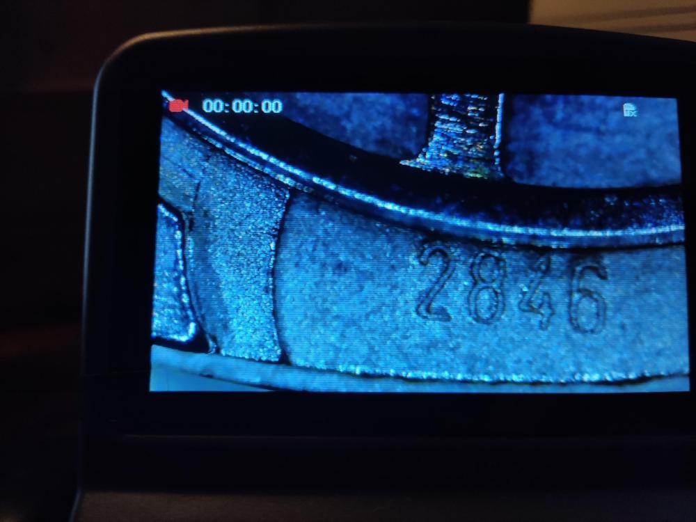

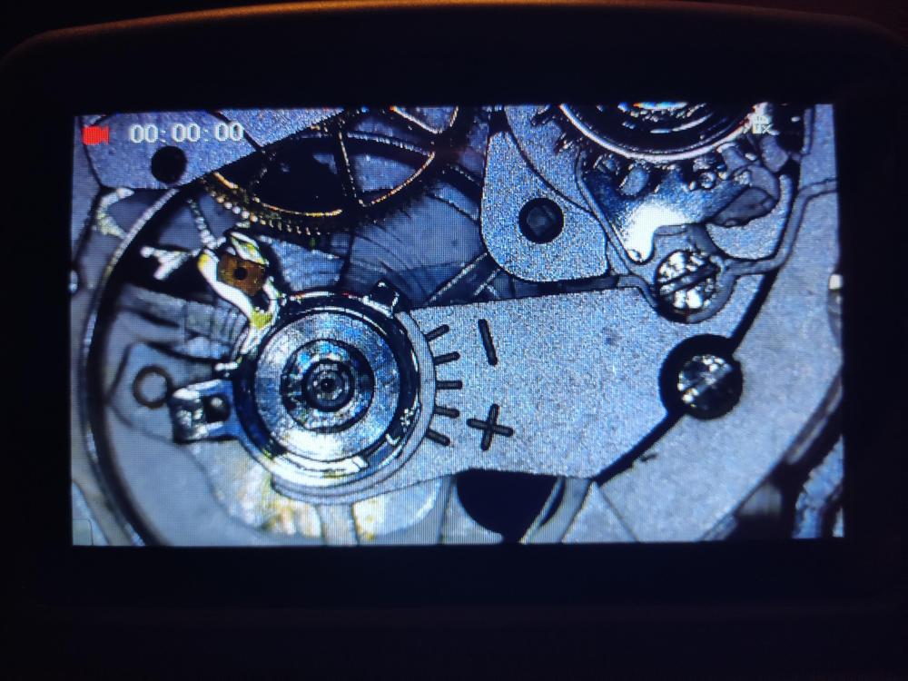

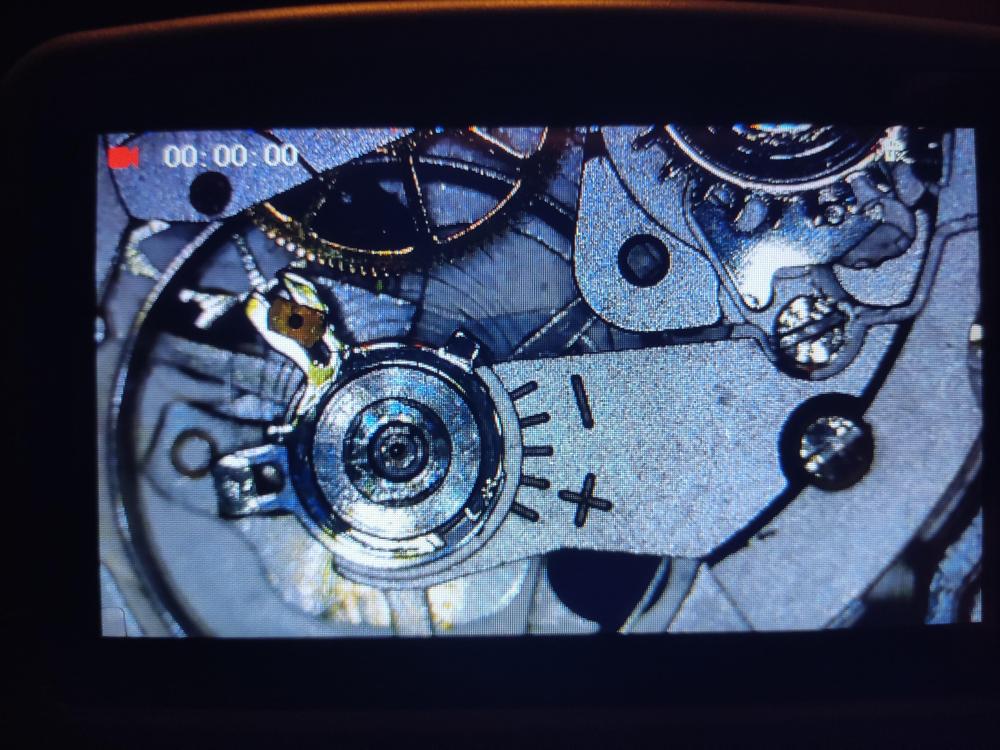

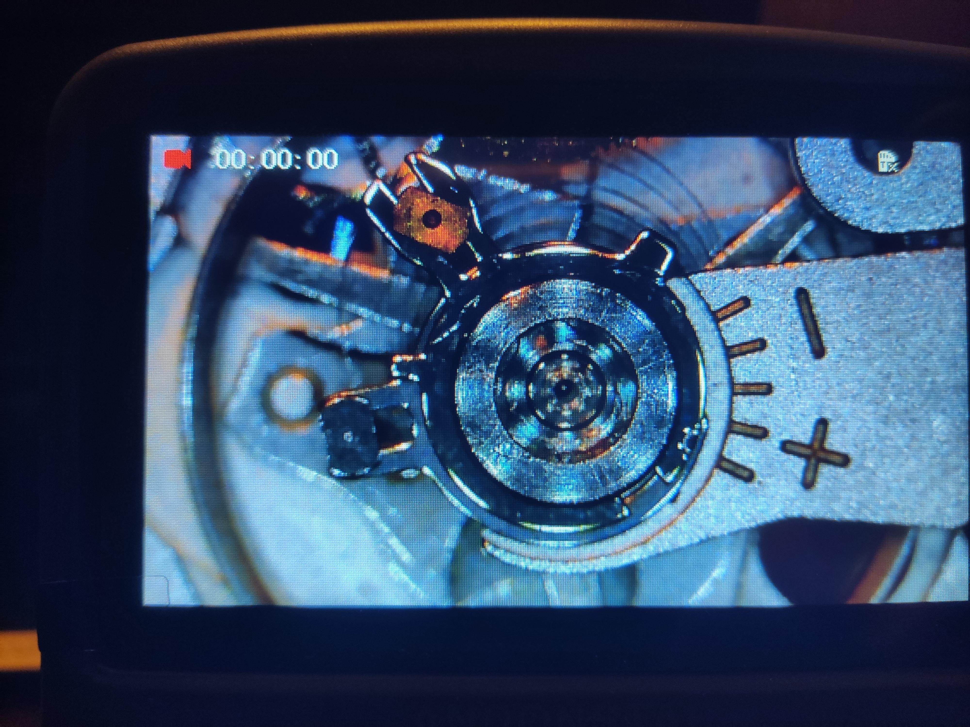

HI John,
Thanks very much for your response. The  photo attached shows the movement and you can see it is engraved/stamped wiith 2846. This is why I was assuming it is an ETA-2846.
Using my caliper, which is probably not really accurate enough, the chaton seems to be ~1.20mm in diameter.
I don't know whether it's helpful, but the spring/clip that holds the jewel in place is not like any of those in the table you sent, but is actually like this one (see attached). Note that this second photo isn't my actual watch, but I couldn't get a good photo of the part with my phone

53 minutes ago, Marc said:
I think actually that it is ETA and not Unitas.
Definitely not Incabloc though. Could be KIF, but also could be Novodiac (they look pretty much the same to me).
Haha, I think you're correct with the Novodiac but like you, I  have difficulty telling them apart.
Oops  😂 ,
 I assumed shock spring is lyre, this one kif or novadiac is pain and risky to lock with the cock in situ, do you have an anvil which can accomodate the cock with balance tangling?

yes, it is Novodiac, I think. This is the tool I bought to install remove the springs
I would still like to see a picture of the regional caliber number and not the OEM movement number. If I do a search 2846 only belongs to eta
Then from the bestfit book we have this
image.png.538a0f55ee38bed79a5c285ac2d83ddc.pngDoes seem to resemble what we have up above though
Does not seem to resemble lists
But when the images are slightly fuzzy it's confusing
now we go back to my original concern or question the base caliber is engraved it was manufactured and sold by somebody else we need their number because obviously they've modified it as a very clearly is not a

I found on the watch back A660/760K. Difficult to read even under the microscope. Googling this number seems to bring up pictures of my watch, although mine didn't say "Seastar" on the dial. IMG_20231102_152043.thumb.jpg.ab46107fac17ccf42879958d535dacfd.jpg
12 hours ago, RichardHarris123 said:
Here you go.
Yes we know that but we have a problem as it's also not that one? Because we would looked up parts for that watch the balance jewel assembly doesn't seem to match and there's something else that doesn't match we need a different picture
Helpful and unhelpful unfortunately. I need a picture now again back up a little bit I need the top of the balance bridge basically I need to see the entire balance wheel and the entire balance bridge you can move the weight out of the way it just get a general shot as we have a mystery?
7 hours ago, lee1979 said:
Are these photos helpful?
Yes those are exactly what I was looking for because I was having a confusion. Then the numbers didn't necessarily help with my confusion all it led to was more confusion and then I saw a better picture which if you guessed confusion you guess the right word.
I believe that's a picture of your shock jewel assembly? Plus my confusion was with the regulator system I thought this was an older movement. Normally the manufacturing information sheet that I attached up above would've answered this question. Because in the typical manufacturing information sheets they specify the different balance shock protection systems and we would've got an answer. But the one attached up above is different than what I'm used to it doesn't have that specification.
Then we have the problem Swatch group they make the watch but who did they make it for? You can go to the eta website download technical sheets for a lot of their watches but if it's interesting Swatch group it's not going to be found there at all. It's still going to exist possibly just isn't going to exist out in the open. This then of course present parts challenges exactly what we've run into.
Let's is figuring out what my confusions where I went looked at another source. Bestfit In the past published cross reference books for parts also supplies parts To material houses. But there also online it's a one time price so it's not free but it's not that expensive either well worth it. For instance let's look up your watch and we see something different.
I just snipped out all the 400 series the lower would be the system that you perceived it is but it is not. It's the upper three that become interesting we have the spring that fits the description of what you have. You do not have individual components unfortunately you get the entire assembly. Think about it as getting the part you need with bonus parts.
Then I get a cross reference to see what else would be using this.
Now I go back to the borel Look up your watch again and wrong part exactly what you have now. But knowing what your part or at least the correct part should cross reference to a track that down and there it is it just doesn't list your watch. So for some reason they are behind on the updates
So once we have a part number and I feel reasonably confident this is the right part number you can go to the main website do a search and it's available.
