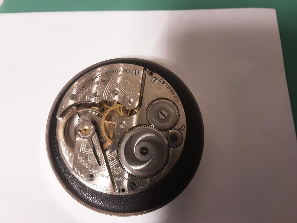

Hi all
I'm looking for some advise, I have two watchs that are displaying the same fault. First is an Admiral, the second is an Elgin. Both have been stripped, cleaned, put back together and lubricated. Everything seems free and moves easily but when the balance is in they both try to run but the escape wheel doesn't move fully so the pallet fork just moves on the same spot. If you move the escape wheel (on either) it's moving freely but both seem to just sit in a position between the pallet fork! (Apologies if this sounds confusing) What am I doing wrong or not doing right.
When I first put them back together they both ran for about 10 mins, then slowed down and eventually stopped.
Any help appreciated
Cheers

Hi John
From the online database it's a grade 290, 16s. There is this lever on the side but I'm unsure what it does. I don't have a timing machine yet, Christmas is coming though lol.

The lever is for setting the time.
Ah thank you 🙂

7 minutes ago, nevenbekriev said:
The lever with the arrow is to switch the keyless works in winding position for service purposes. Put it as on the photo, othervice the movement will stop again.
Ah, I've got it in the other position, thank you.
I see somebody beat me to the answer. As some were up above it was stated American pocket watches out of their cases typically go into setting a mode. So people assemble the entire watch before worrying about whether it runs will find that they don't usually run well out of the case as the trying to drive the entire setting mechanism. So the watch companies usually but not always had a way of putting it back into running mode which is what that is for. The other reason for having this feature is the movements are typically sold without a case and then the case was available separately in this way the watches could be running out of the case when you're showing Thereto the customer.
Oh and then each watch company typically did this differently so you not go to find the exact same on any of the pocket watches. Plus there tends to be an evolution so it's conceivable different watch companies may use different systems.
Ideally when assembling a watch once it gets to the basics then you a check it on your timing machine and verify that it actually runs before making the assumption that it is going to run perfect. Sometimes it's even nice to just let it run overnight in that condition I do that quite a bit because I don't want to case the thing up and find a surprise of it wouldn't even run overnight for some unknown reason.
