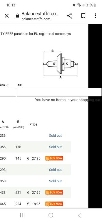

Thank you for accepting me, and I apologise for not replying for some time. I seem to have a problem replying to comments on here. Well thank you for sending me a link for the balance staff. I found three and one was for a chrono so that narrows it to two. I was impressed with the way the new dial face was printed. I have been trying to use a pin to repaint the little bars on the outer second ring, and it is not working. If I can find the paper and get an expert to design a black dial with all the markings ,that would save me a lot of eye strain ! Brilliant video. Well I was not sure if I had the right site when I came on here so I shall spend more time here as it is very informative. I love the way you chaps whip all the components off a watch, clean and oil them and then put them back together again.  I shall keep going and practice and learn. Thanks, Mike.

Hi John. I did scrape that off so no problem there. I found some details of the leonidas pocket watch. An  U with the T inside is for the Unitas company. Its a caliber 6497- 6498.   19 Lignes and the movement number is : 122753. The balance staff I think I am looking for is : BS 3465, 19 ligne, caliber 34/12 and  (A) 520mms, and (B) 274mms. I have not got a clue what all that means except A and B are the sizes in mm/1000 ? I believe Swatch is the company that bought up most of the smaller companies, and I found some interesting stories of how the Swiss went about  fighting off many new companies who manufactured movements back in the day. I think the best way to repaint the dial, is to spray it black and get a transfer like Mark did.
I'm curious as to how you work this out? Yes the UT part is right but was the caliber number under the balance wheel for instance?

Here's the measurements, as for the dial, it's your watch.  Many people will think you should of left it as it was but opinion is divided.
Thank you Richard. I have just found out how to answer other members ! So did I have the wrong measurements ?

There was the UT stamp and a curious bended railway line  motif. The number was 122853, but the 8 was over stamped with a 7. I will take the balance out tomorrow and see if anything is stamped there. I spent hours looking up various watch sheets of different makes. I found a german site and it listed 4 different types of leonidas makes, and on I believe was South African. I clicked on a link on here if I remember right. I used to do a lot of investigation work in my final job, and I tend to go all over the place looking for clues !
The reason I'm asking about the caliber number is if it's not the right caliber the balance staff isn't going to work. So for instance what does a 6497 look like well it's at the link below and I'm guessing yours was made before these were. I don't suppose we can have a picture of the dial side of the movement so we can see the setting parts?
http://www.ranfft.de/cgi-bin/bidfun-db.cgi?10&ranfft&0&2uswk&Unitas_6497
