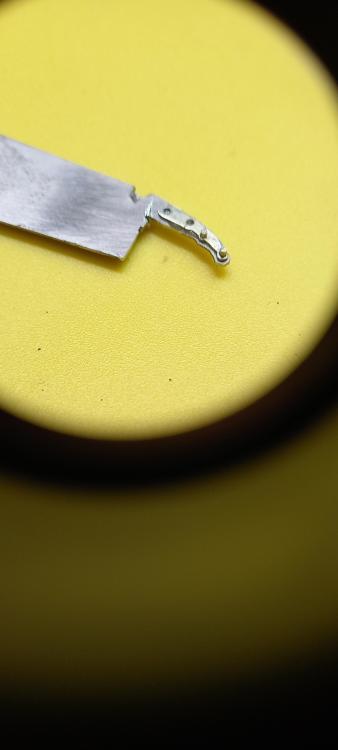

How are you getting on with making a setting lever @mikepilk, i need to make one for a Kasper 700.  This has 3 pins and a tapped hole, so 4 holes in total to drill. Any luck with the annealing, I've found it possible to rough out the shape in its hardened state using a 20mm grinding wheel. But for shaping the fine details it will need to be soft to be able to use files and drill the holes.

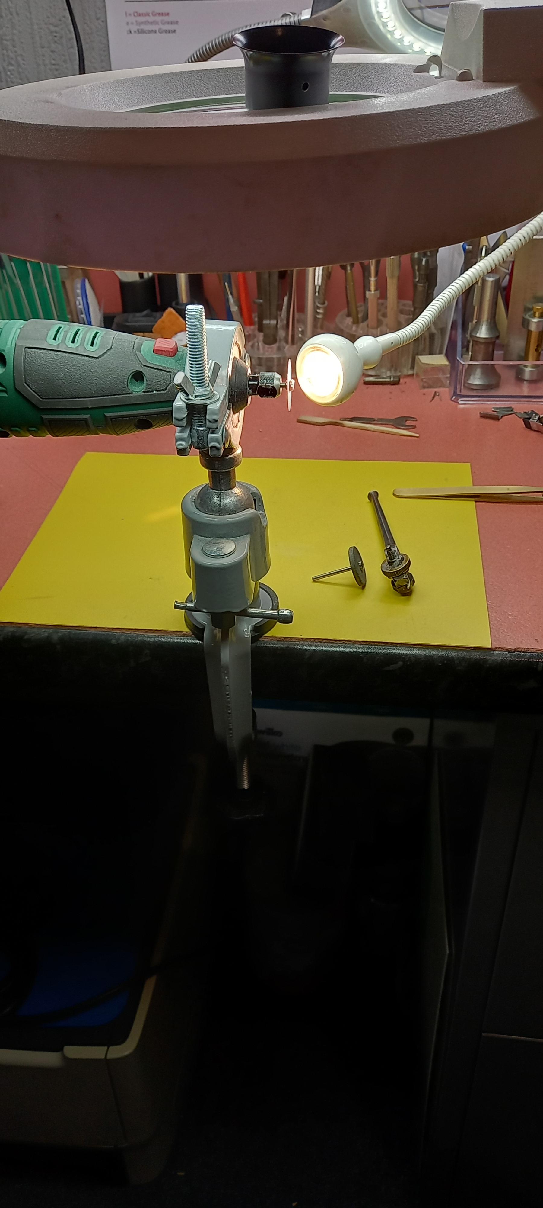

This is basic roughing out set up 2.5x magnifier and a 5x loupe gets you close enough to see to remove the bulk of the waste safely with a 20mm grinding wheel and then some detail with the cutting edge of a diamond cut off wheel. Dremel type drill has to be on the lowest speed for any details , its surprising how quickly what you want off at the end is removed. You also need to be mindful of your approach angle, keep the piece square on to the wheel at all times its extremely easy to undercut the piece you are working on. Lastly dont try to be too clever leave the last bits for some steady filling, you only want to make one of these 🤣20231120_203635.jpg
I managed to find a setting lever so gave up trying to make one.
The first one I made, using a feeler gauge, took me two attempts to anneal, but it somehow worked, and was so and easy to saw and file.
The second time, using the same set of feeler gauges, I just didn't manage to get it soft enough to work.
I now have some powdered charcoal, and a cut down box spanner to use as a cylinder, for the next time I try annealing.  I hope to get it all red hot with a hand held butane torch, and it cools slowly enough.

Finally got around to annealing my homemade setting lever. First attempt was half of the old part wrapped in copper strand from flex, that didn't work the copper melted like hair on my head. Second attempt heated the same part just held in the air for 10 mins with a small butane torch gradually reducing the flame and moving it further away. After chipping away the  outer carbon layer that had formed i was able to drill with a 0.4 pivot drill part way a hole behind one of the pins so i could remove it. Very slow going and had to sharpen the drill 4 times, gave up that idea and decided to stop fannying around. Final attempt involved the use of a compressed air pistol cartridge for the annealing cylinder a couple of spoonfuls of ground charcoal scavenged from my chiminea and 20 minutes of the old faithful Rothenberger torch. Yeah, no don't try this in your upstairs converted bedroom its not a particularly safe practicebut i am a professional and did have contingency plans in place if things started to go pear-shaped,  and its fricking freezing outside. Results to follow. 20231202_134220.thumb.jpg.d7ce07a939037f62cd571339aa615bf9.jpg20231202_161036.thumb.jpg.a1324e54a90b96d47d56182a03a362ce.jpg20231202_161507.thumb.jpg.130282028107ea31b4518bc1313ec042.jpg

The cylinder and its contents were cool within the hour. The difference in drilling is night and day. The first photo was probably around an hour trying different drills, cheap carbide ( absolutely rubbish and chip when you give them an angry look )and  resharpening a 0.4 pivot drill 4 times, i barely managed to make a start, just a very shallow shiny dent. The second photo the hole is through the piece up to the pin on the other side i just need to widen the hole so i can pull out the pin. This took just 5 mins hand drilling with a pin vice and just one initial sharpening of the drill, not easy to sharpen  a .4 pivot drill, the angle is awkward to get as the clearance on one side affects the cutting edge of the opposite side more than it does with a dormer hss bit, the angle has to just so.
