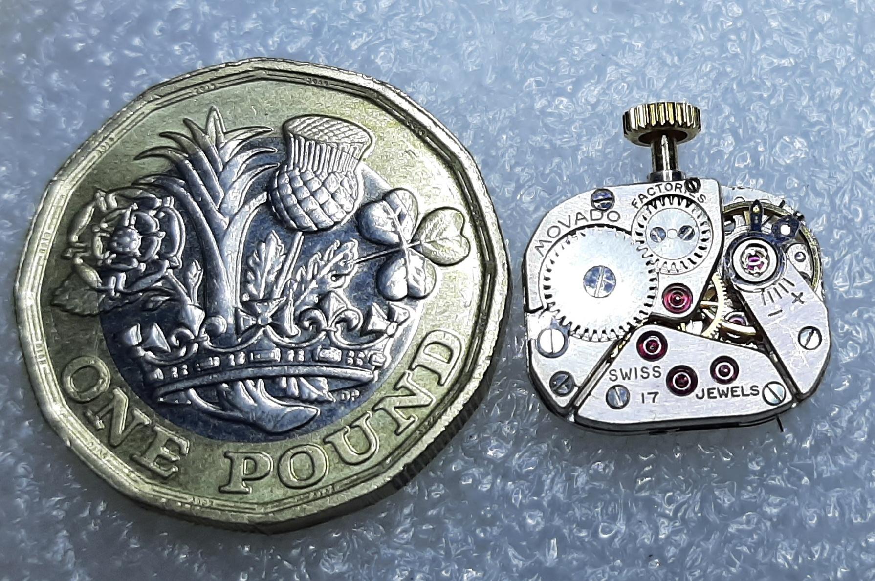

I managed to shear off the head of the barrel arbor screw in this ridiculously tiny movement. Can someone confirm I'm not going insane, and that these two screws are reverse threaded? There are no markings to
indicate direction.
I've purchased a donor that I can use the barrel arbor and screw from (and anything else I manage to ping into space), but I really don't want to destroy that when it turns up...
Turning in the direction of these should loosen these screws, correct?
Also, I need smaller screwdrivers, damn.
The crown wheel screws are always (?) reverse threaded (if it's only one screw in the centre), or they would tend to unscrew as the crown turns.
The Barrel screw is almost always a normal thread, though a few are reverse. You can try them either way if you turn the screwdriver a tiny amount.

Cheers! Turns out this one must be reversed. I turned it the normal direction and it sheared.
Actually, I'll try and see if there's enough thread remaining on the screw to check.
Edited by lexacat
thanks @mikepilk !
They are both definitely reverse threaded 😃 Mistakes were made 🙄
Once the donor gets here I'll just swap out the arbor and screw, but what a pain! Also waiting on a tiny movement holder, this thing is so tiny!
As an aside, there's no way I'm servicing the mainspring. I don't have a winder small enough.
