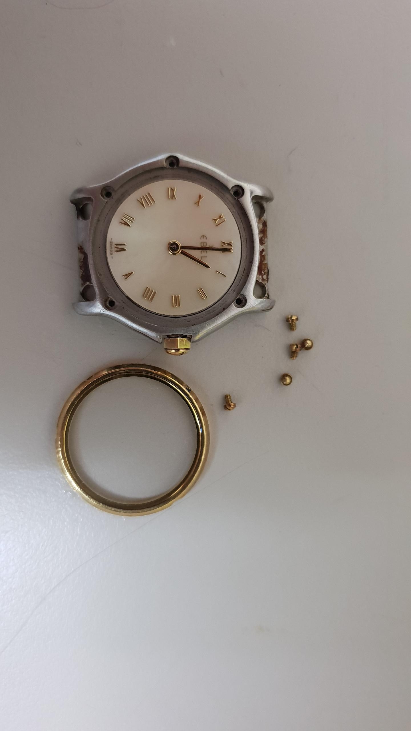

From what I see, the crystal is made of mineral glass and is secured to the bezel with a sealing ring. If you might want to replace the crystal without removing the bezel or the movement, I think it's possible, but risky. You have to suck out the old crystal without breaking it into tiny particles. I would not do that. If you remove the movement first you can press the crystal out and press a new one in without removing the bezel.

It's difficult to tell, but my guess is it just looks like it has a bezel. Once you have removed the movement, you should be able to tell. Either way, I think you should be able to press out the old crystal from the inside as long as you have a die that properly supports the area around the crystal. So, take it a part first and then assess if any additional tools or actions are needed. Let us know how you do!
