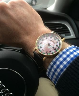

Michael Posted August 31, 2015 Posted August 31, 2015 Progress to date on homemade watch parts, The movement is an Avia I bought off ebay for a few pounds. I will buy the glass and strap in the future (hopefully if things get that far).The plan is the rest of the parts will be DIY Case fabricated in 3 parts Raw material for case ). 6 Quote

Michael Posted October 6, 2015 Author Posted October 6, 2015 A bit more progress. Just the crown to make, put on some dial markings, and a clean up and tidy. Hands made out of a broken main spring. Hour wheel extended Fourth wheel ground down to remove sub seconds Crown will be made out of an old brass bolt and fitted to an extended stem Dial markings to be added Watch is keeping good time 5 Quote

Michael Posted October 7, 2015 Author Posted October 7, 2015 Hi Geo, I had not thought of changing from the raw brass and just buffing when needed. However, your post has got me thinking. If I do anything I think it would be gold plated, unless you have any other suggestions? Hi Vic, they were done by hand, and I am not entirely happy with them, but time restraints means I need to press on. The method I used was actually quite easy, and it was as follows; Cut an over lengthed piece of main spring and bend reasonably flat Soft solder at the ends to a thin piece of oversized brass. I used 0.5mm as it is what I had for the dial base Drill the hole where it fits onto the hour wheel Then use a dremmel type tool with grinding disc to shape your hand to how you want it. The brass helps to grip it, and also to control the grinding. During the grinding the hand will naturally come away from the brass. Grind off to finally release the hand from brass sheet., Tidy up as required with dremmel type tool and then sand on a piece of wet and dry, both sides. I put the hands on a 2mm piece of brass sheet and heated from underneath. As soon as hands start to turn light blue take the heat away 1 Quote

Michael Posted November 8, 2015 Author Posted November 8, 2015 Crown made and dial markings put on. Glad to be getting close to the finish line!! 4 Quote
