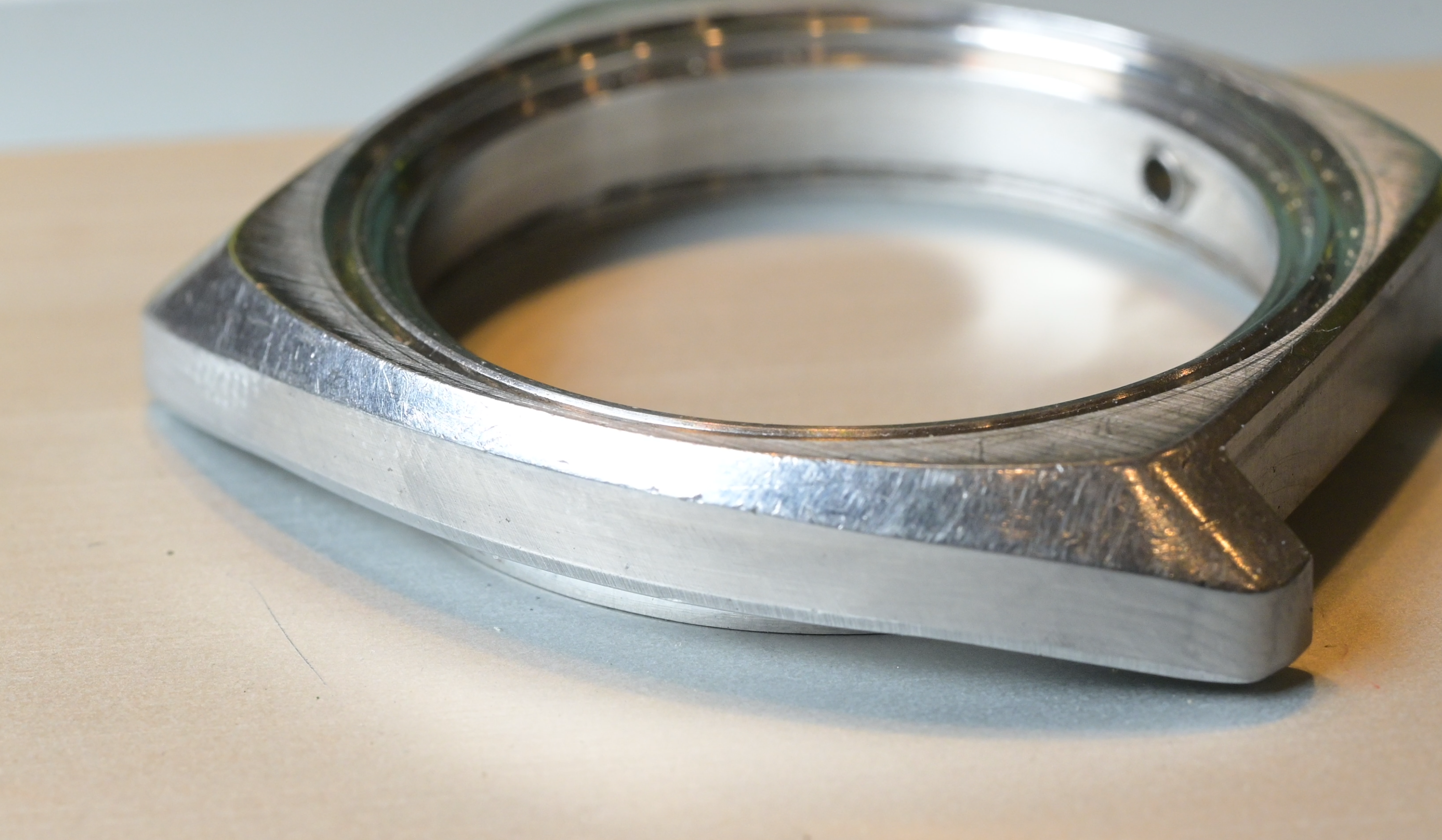

I decided to do a little improvisation last night. I had a case where the sides were extremely worn, dented, etc. The case lines were nearly worn completely down.
I've wanted a lapping machine for some time but those are far too expensive for my humble budget. I improvised by hooking up one of my sanders to a voltage regulator to bring the speed down as much as I could. I put some 1000 grit paper on the disc and started to gently work the side of the case. I'm quite surprised at what I was able to accomplish with these rag-tag tools and bit of creativity. I'm limited by the table because it can only adjust to 45 degrees, so there are some angles on that case I won't be able to reach properly. While looking up pictures on the internet of other examples of this case it looks like there was not a sharp line between the side wall and the lugs, so I just tried to bring back a gentle curve between those to sides. Not too bad for my first attempt! I'm going to keep moving forward and go up to 2500 grit and see what I can get out of this before moving on to the polishing wheel.

Look great, did you re-brush the top edge or is that how it was ?
I re-brushed it.  Originally it had vertical brushing, but it was all but gone by the time I got the watch. The light reflecting off the top makes it difficult to see the brushing, but it actually looks pretty good in normal light.  As I stated earlier, I'm not a photographer by trade, haha!

Apologies for digging up an old post but I am thinking about doing the same. Can I ask the OP what medium he used on the wheel. Was it a sanding disc and polish and if so what grades. Thanks.
Since I couldn't slow the machine down enough for my liking, I started off slowly with a higher grit.
I began (very lightly) with 1000 grit paper:
https://www.amazon.com/gp/product/B07DTJBND1/ref=ppx_yo_dt_b_search_asin_title?ie=UTF8&th=1
Finished with 3000 grit:
https://www.amazon.com/gp/product/B07DTFSMT1/ref=ppx_yo_dt_b_search_asin_title?ie=UTF8&th=1
Afterwards I went on to polish with traditional methods using felt & cotton wheels, with different grades of Dialux.
Hope this helps.
