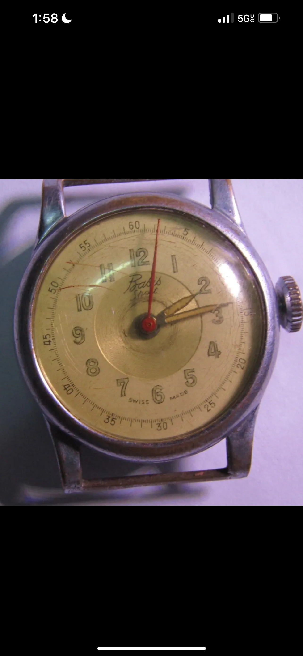

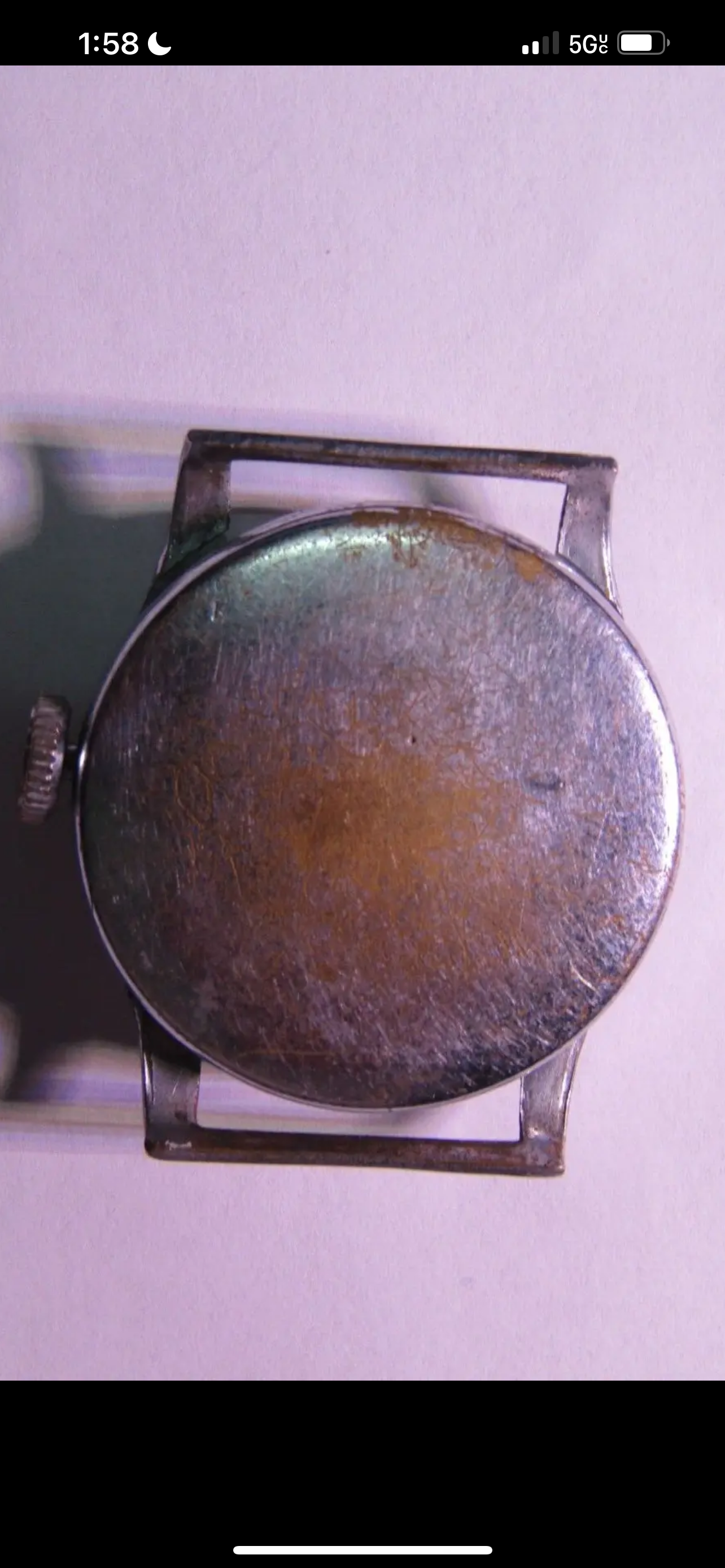

Basis Sport watch

Buying a specific jewel for a specific movement is difficult if not impossible in most cases. cousinsuk/jewels
your best approach is to measure the current crystal and find a replacement at an online watch parts supply.
The jewels in the barrel train bridge appear to be set or rubbed in so your best option would be a new bridge. The balance jewel looks fine to me.
