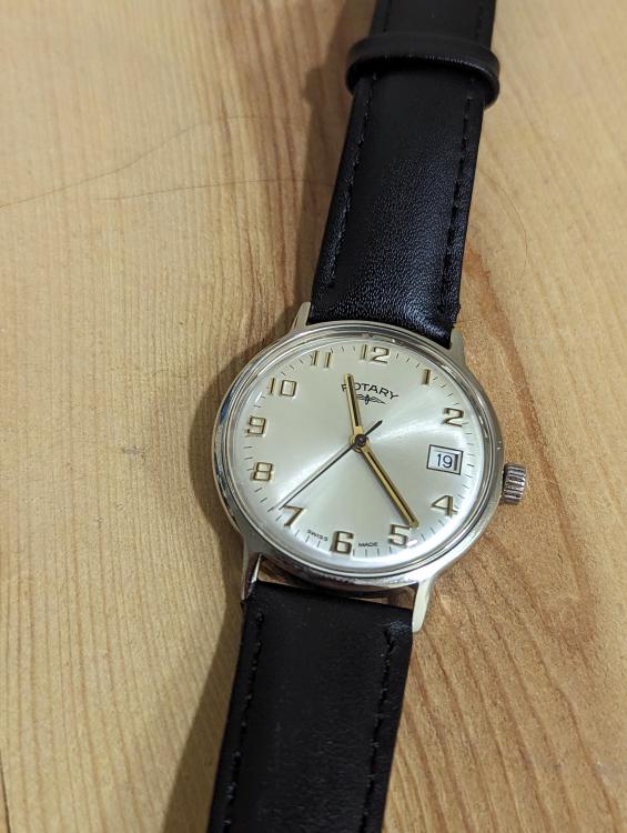

Due to my location (and I'm a cheapskate) it takes around 2-3 weeks to get a new crystal, hence I have had to develop my acrylic crystal refurbishment skills to revive the original crystals that come with vintage watches and I thought I would share how I do this as I now have pretty good results, assuming the crystal has only scratches and no cracks or chunks missing here is my process:
  1. Use 320 grit wet-dry paper over the entire surface of the crystal evenly to remove the deepest scratches - hold your nerve, this will look terrible after this step
  2. Use 600 grit wet-dry paper over the entire surface of the crystal evenly to smooth out the results of the step above
  3. Use 5000 grit wet-dry paper over the entire surface of the crystal evenly to further smooth out the results of the step above
  4. Use Autosol metal polish (see below) in small circular motions over the entire surface of the crystal evenly with a cloth until the paste disappears, may need to repeat this step 2 or 3 times, this will get you 95% of the way there
  5. Use Autosol acrylic polish (see below) in small circular motions over the entire surface of the crystal evenly with a cloth until the paste disappears, rarely have to do more than one application, this will finish the job
Side note:
I have tried the Autosol acrylic polish side by side with Polywatch and there is no difference in the performance or how it looks/feels - I even got my son to decant some of each into containers in a double blind test and the results were indistinguishable. Hence, in my experience, the only difference is that gram-for-gram the autosol acrylic costs 3.7% the price of the polywatch.
Here is a quick example of before and after using the above process:
Edited by Waggy
Clarifications and typos

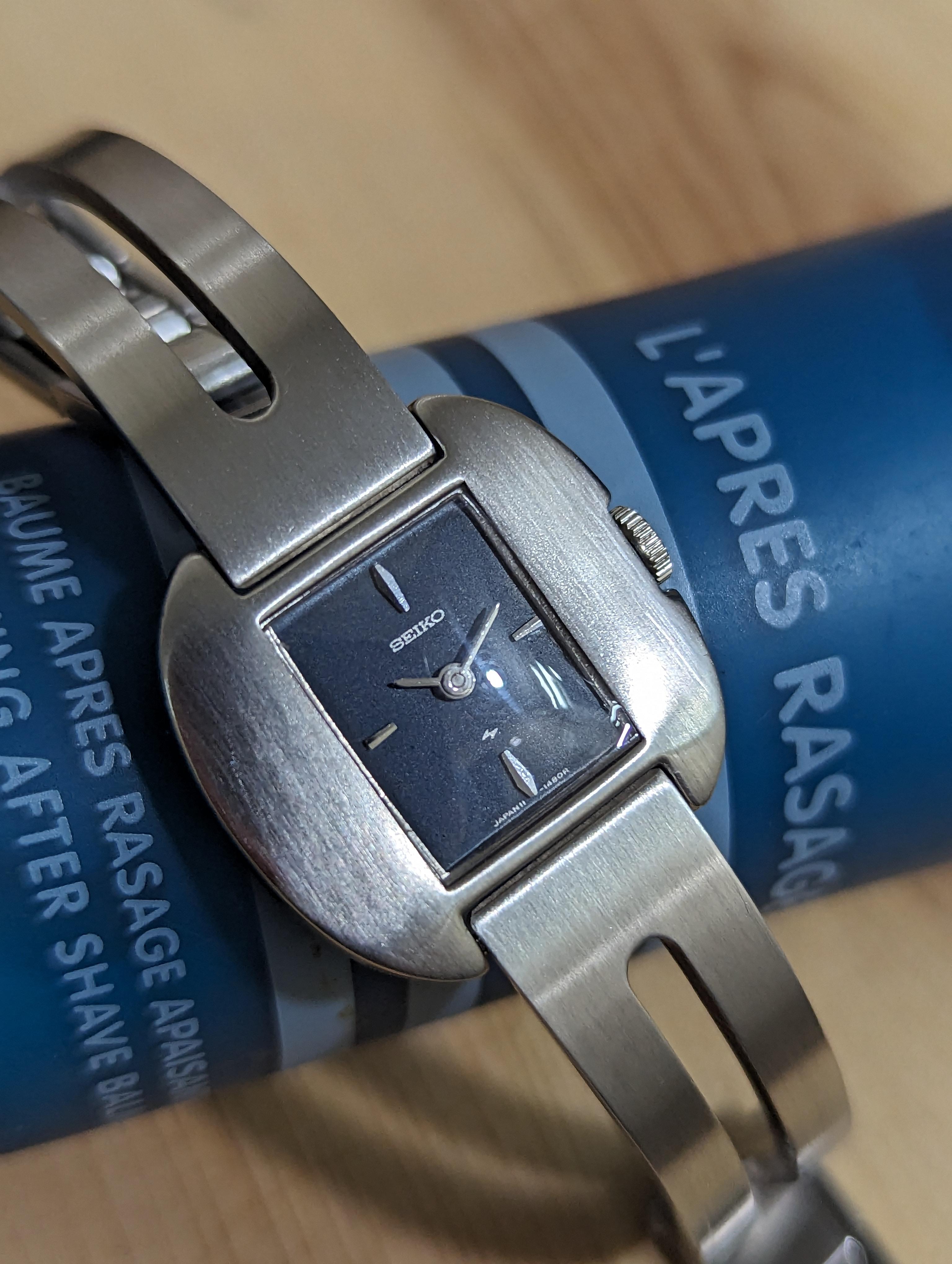

I used these lap wheels which feel like those green scotchbrite pads you scrub your dishes with from our friends at CousinsUK:
I have a few of them, the fine gives a frosted effect where its less obvious the direction of brushing, the medium (I think I used in this case) shows the direction, and the course I use when the brushing is a very visible feature
You should only use these lapping discs after you have buffed and polished the rest of the case - I mask off the areas I don't want brushed with heat tape, helps to use a fresh razor blade to trim the heat tape.
Here is an example of the finish from the  fine disk:
Edited by Waggy
