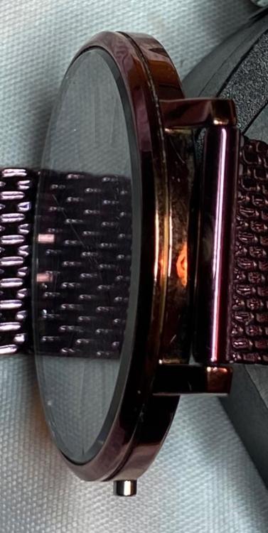

I hope somebody might be able to give some advice on removing this dial and movement.
I was given this watch to repair (refit the loss gems on the watch face), but I stumbled over the first obstacle, of not being able to remove the dial. It appears to be sandwiched under the case somehow.
After reading some threads I think it might be a front removal, but I do not see how the case can be easily separated without doing  some damage.
Any advice  is warmly welcome
Cheers Andrew

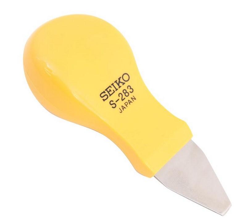

There is sometimes a small "lip" in the case where the bezel can be removed with a case opener. You will have to look around (using magnification) the seam where the bezel and case meet for it. I have had good luck with the Seiko type opener. Place plastic bag under the tool to help protect the case.

Just to finish this thread. The bezel is not removable, but rather part of the watch case. I did try to remove it, but I only ended up removing the anodizing in the ridge. Hence the case and bezel are one piece.
The solution is to remove the crystal. I did this by pushing on the movement from the back of the watch and the glass popped out followed by the movement. Richard was correct and that helped me a lot.
Thanks to all that helped and keep my motivation going.
