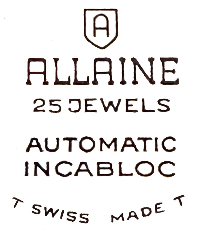

I had a go at cleaning it right back - it is still a little pitted but the battons shine and the starburst effect is still there.
I have a very similar watch in gold plate - perhaps I can photograph it and make some decals? (never tried this before…)
Edited by ColinC
Looks like my printer resolution is not high enough to print the decals as I hoped. My laser printer does 600dpi
Here is a zoomed in shot of a print at the right size on paper - I don't expect a decal to look any better!
It all looked OK as a PNG file
