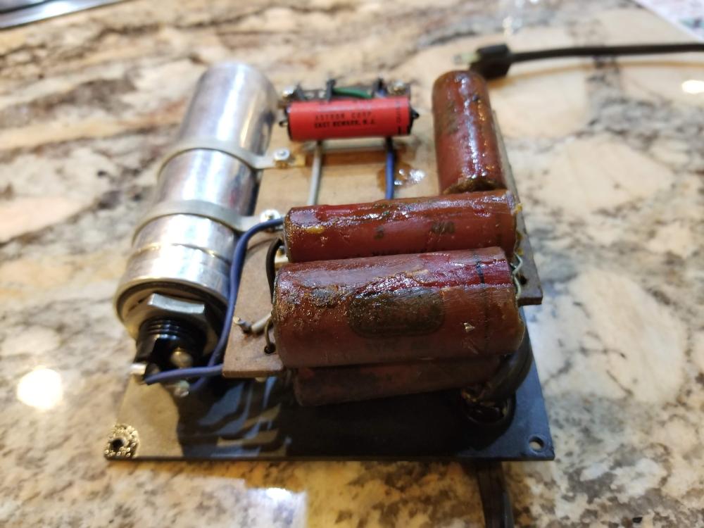

I didn't really see a forum to post issues/questions relating to demagnatizers, so I am posting here.
Any EE's here?  I bought a vintage demagnetizer and just received it.  There was an oily substance on it, which seemed strange.  So, I opened it up.  Oily stuff all over the inside cover and components.  Leaking out of the capacitors?  Not sure if this thing is safe to use or I should try to return it.
That's the problem with buying vintage electronics. Unless you know how to repair and refurbish electronic equipment or are willing to spend money getting someone to repair and certify it safe, stay away from vintage electronics.
Those look like film capacitors and are unlikely to leak anything. It actually looks like paper/foil capacitors. Some of them were coated with a varnish to insulate and prevent oxidation of the metal foil. The varnish could have deteriorated into that oily stuff.

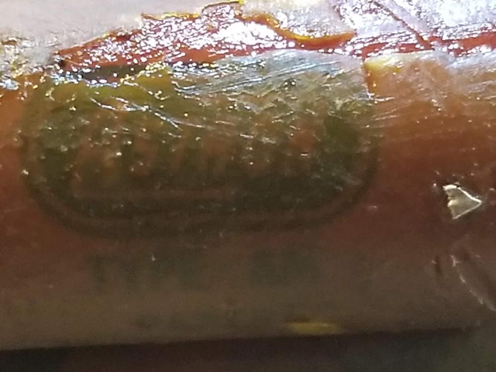

Could you get some closeup photos of the markings on all the capacitors? That would help us identify what kind of capacitors they are.

Well, I was imagining simpler electronics.  I've worked on various electronics projects before, but am not familiar with these capacitors.  One of them looks perfectly fine, but the other 3 look oily/waxy.
Edited by gpraceman
All of your mylar and paper capacitors are probably okay it's this one that I would be concerned about
Especially since something has leaked out from somewhere unless it had leaked in from the top through the cracks in the case leaked from somewhere it's probably This is this looks like electrolytic capacitor. This should be markings on it some place just not visible in the photograph

oil type, which is the best kind of capacitor in my opinion
We won't know until we get the numbers but something leaked and all the other capacitors shouldn't have anything resembling a fluid.
3 hours ago, gpraceman said:
The big silver cylinder, if that is what you mean, doesn't have any signs of leakage.
Interesting I need to improve my reading skills it doesn't look like this leaked? So if this didn't leak what exactly was leaking?

I'm not seeing any signs of leakage from that.  Here's some photos of it.

I am only seeing the oilyness on the 4 paper capacitors.  There's the smaller one that doesn't show that oilyness at all.

It reminds me of in one of the newer demagnetizer they're using a motor starting capacitor in the case of the one that I was looking at it is a solid capacitor but yours is probably filled with something. But it still brings up what exactly was leaking? Is there anything lurking underneath the circuit board or the whatever board that is?

Here's some side views.  Nothing else seems to have that oily substance on it except for a spot on the board.

Maybe what leaked came down from the top is in a box with other stuff and something gets spilled on it? Out of curiosity if you plug it in preferably when it's back in its case and push the button that what happens?
I did a quick operational test of it (in the case) with the cover screws placed in the white zone.  It caused the screws to jump due to the magnetic field pulse and the light flashed briefly.  That is all as should be expected.
There was only a bit of the oily stuff on the outside of the case and lots in the bottom of the case.  It rather seems that the stuff leaked out of the case (not into the case) as it tumbled around during shipping.

The silver Aerovox capacitor is not electrolytic most likely. Otherwise we wouldn‘t have two leads of the same color soldered on. So it should be safe.
EDIT:
The Aerovox 610 is an oil filled metallized polypropylene film capacitor as @HectorLooi mentioned already.
