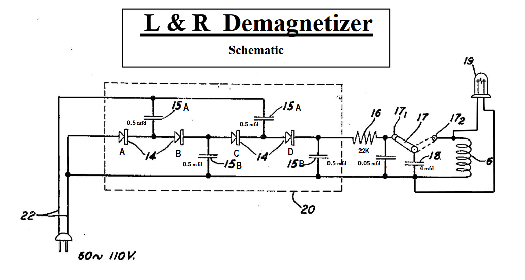

Is this safe to use?
4 hours ago, gpraceman said:
I don't see any diodes.  I see one large resistor and a couple of selenium rectifiers.
A rectifier is a diode.
Ah.  From what I had been reading it does seem like those should be replaced.
The switch sticks in the down position, so that may also get replaced.  Seems just like a two position switch, so a momentary on SPST switch would do.  I see the capacitors rated up to 600V but not sure the voltage that the switch actually sees.
Great idea.  Having that, I could keep the demagnetizer plugged in but switched off.  The visual verification of it on or off, that the LED provides, is nice.
Once the various components are replaced, will it be more effective than a cheap modern demagnetiser?  If not why bother?  Genuine question's, I'm just interested.  I have two demagnetisers, one cheap Chinese one, works OK, one homemade, a central heating pump with the rotor removed, very powerful.

The cost of a new instant demagnetizer is rather expensive.  An Elma unit from Cousins is £207.95.  Even with replacing components on the vintage unit, it should be significantly less cost.  Not sure on the cost of components yet (which should not be a lot), but I only paid $50 for the unit.
Cheap, to rebuild. Far better than the cheap units IMHO.
The big cap is $10. All of the other components total less than $5
I found an Elimag schematic that is pretty close to what I see with this L&R unit.  I made some alterations to it reflect what I see with the L&R.  With the L&R there is an extra capacitor, the 0.05 uF capacitor (the one in my photos that is not all waxy/oily).  Not sure what the purpose of that one is.  There is no 220 Ohm resistor or a resistor for the light.  Though maybe the light has some internal resistor.
It looks like I made a mistake on the switch.  It is a SPDT.
