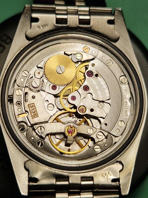

I just finished a service on a Rolex 3135 in a lovely Datejust 16220.
First, here are some overview pictures of the movement:
20231221_235126.thumb.jpg.7842cc1e13afab0383b6bef3f76cbf45.jpg20231221_234619.thumb.jpg.f47e6609d2d3fc855d9bf732962c9385.jpg20231219_214117.thumb.jpg.eb6a76e29a754dd68d7142b36295b4ba.jpg20231219_215200.thumb.jpg.b3587bf2aae67f1808d1559db4408200.jpg20231219_215603.thumb.jpg.6d89bf383f406b02514f1121a1e9ee63.jpg20231219_221213.thumb.jpg.98460f137ddaf2bb2d325c02e7c503b5.jpg
The watch was in overall good condition, but it was running a bit fast and inconsistent (across positions) and amplitude did not reach 250 even fully wound and dial up.
Upon disassembly, I did notice some a bit of dirt and some jewels/pivots had run almost dry.

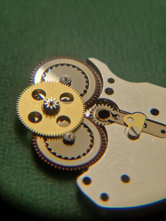

The barrels shocked me again (similar to the Rolex 2035 that I recently serviced):
20231219_230007.thumb.jpg.6020201d3f50337128001035e0a434d1.jpg20231219_230705.thumb.jpg.9925fecf5df652c72b50967132559d75.jpg
Thanks to @JohnR725, I had access to detailed oiling charts and service training guide: https://www.watchrepairtalk.com/topic/3626-rolex-3135-beat-error-adjustment/?do=findComment&comment=234180
After some good pre- and final cleaning, I assembled exactly as prescribed by the Rolex training guide that I followed the service guide in detail.

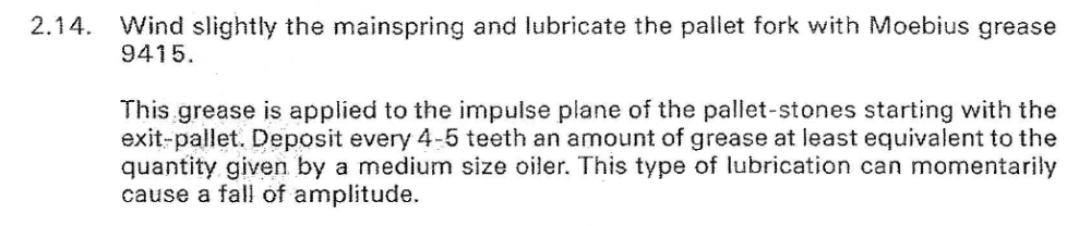

Regarding the pallet fork, the Rolex training guide seems to suggest a rather large quantity of 9415.  Consequently, I put more than I usually would (but still less than the suggested amount by Rolex). See pictures below. What are your thoughts?
VideoCapture_20231221-164227.jpg.986264b2218e9736df4163bdf9f23760.jpgVideoCapture_20231221-164303.jpg.43f5d964d92600acfa4a64f2700a926a.jpgVideoCapture_20231221-164313.jpg.65de1a517475794480aa32f25a23ecca.jpg

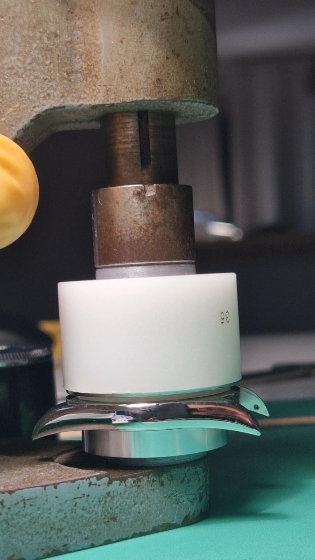

The previous watchmaker left me a present under the bezel. I noticed that it was not sitting perfectly even on the case. He (or she) must have removed the bezel in a way that damaged it a bit. I filed the damaged metal away with a diamond micro file.
20231221_172613.thumb.jpg.490593575c32d2458d673bb9e8cc7313.jpg20231221_204742.thumb.jpg.68586ba7c81e7304f68a1d6a1293379b.jpg
Bezel back on with my trusty Robur (with 3D printed adaptors for "standard" M4 dies).

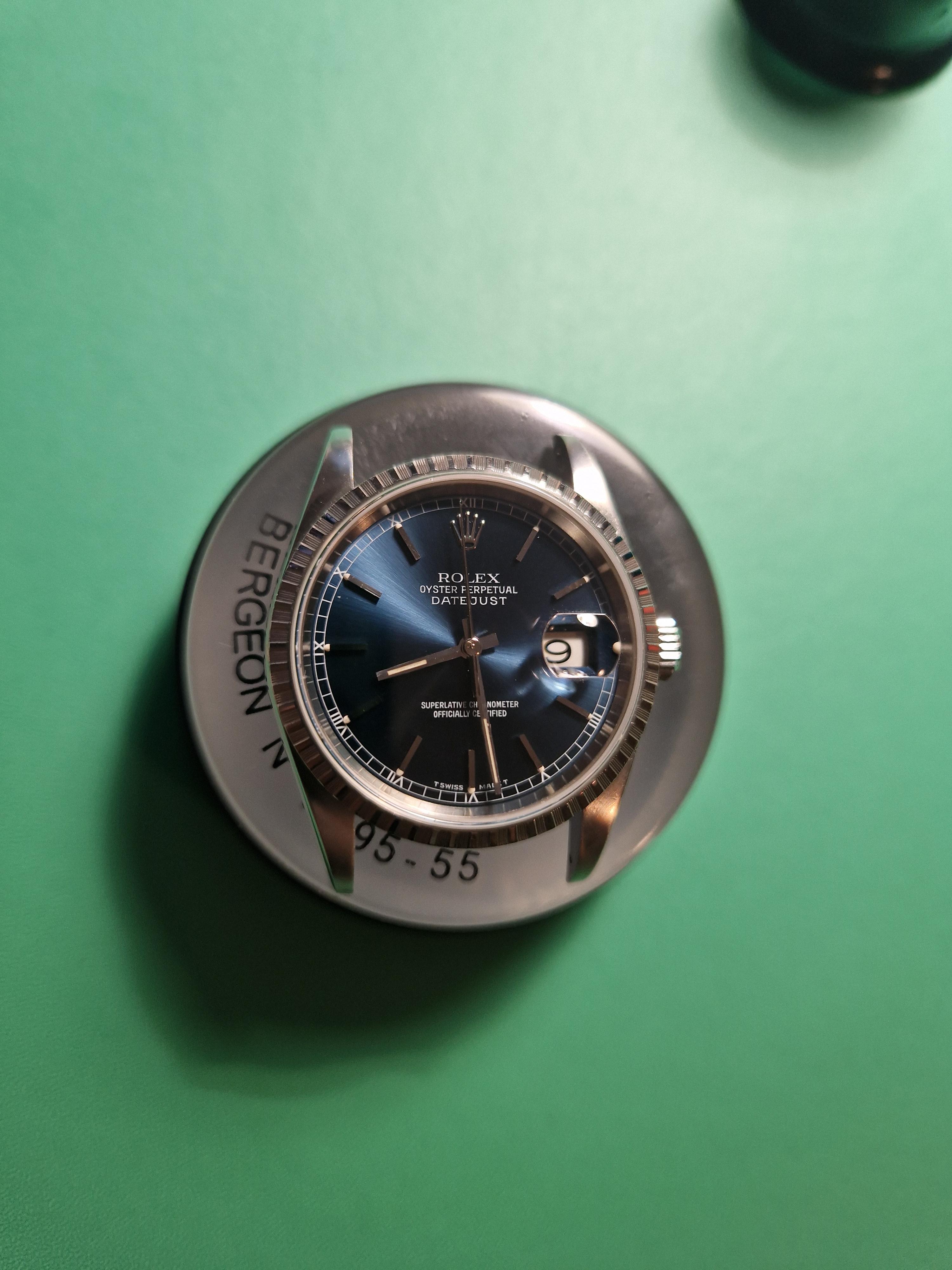

The dial and hands also got a bit of cleaning :
Before:
After:
When I was in school basically the Rolex recommendation is what we had. Small blob on the impulse plane of the exit jewel and then you move the pallet fork back and forth so one third of the teeth go by another small blob another third and then one more. But at the time I was taught we were using 9010 on the escapement now of course it's 9415. The catch the 9415 is in some situations if you get too much you will lose amplitude which is why Swatch group goes to the insane lengths of an electron microscope and putting extremely tiny quantities on the stone letting it run etc. etc. I'm joking about how obsessed they are on the other hand they usually recommend replacing the escape wheel and the pallet fork because there is another lubrication which is applied at the factory that we can't do. I'm attaching the Swatch group recommendation for lubrication
if you are really concerned about over oiling I would do the method like Rolex or I just suggested let it run for a while take the pallet fork out rinse it off and put it back in again and you should be fine. But your amplitudes look fine anyway so I just wouldn't worry about it.
Often find on the group of people sometimes go to minimalistic I think in a recent discussions somebody said they put one drop and somehow expect that the magically spread all around the escape wheel and conveniently I just looked the other way and ignore the whole thing because that's not enough lubrication.

Thanks for responding!
Funny you say "if you are really concerned about over oiling"... While I really wasn't concerned by it, I had this random/nagging feeling that I may have forgotten to lubricate the mainplate jewel for the mainspring barrel. Conveniently, it's possible to take out the barrel by only removing the automatic works, ratchet wheel and barrel bridge. The movement can even stay in the case. So I did that and, well, found that there was oil. So I didn't forget. However, I noticed that the upper jewel (in the bridge) was barely lubricated. Funny how my mind led me to that issue..
Anyway, so I lubricated the bridge jewel properly now and... amplitude is now through the roof! When I took it off my wrist after a few hours of wearing (and it was fully wound when I put it on), the timegrapher went up to 330°. Now I'm actually a bit concerned that I risk knocking. But it calms down after just 1-2 minutes and goes to 300-310°.  So I think that the risk of knocking is low as you never really wear the watch in a perfectly horizontal position.
Wound to the limit, straight off the wrist and onto the timegrapher (dial up):
After just 1min:
