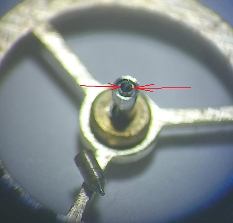

But You shoud put in place down side tampon before fitting the one that was out and repaired. It could be done easier thru the hole of the cylinder untill it was open. Now You will have to do it the little harder way.
OK, use anvil with hole that will accept the size of the narrow part of the tampon (shown with arrows), but will not let go thru the wider part. Then, put office knife blade (the back, not the sharpened part) in the cut part of the cylinder, on top of the tampon, and press the tampon with force by pressing on the knife blade thru balance spokes, as close to the tampon as possible. The wider part of the tampon must be on the same hight as the downside end of the cylinder tube.
20231227_221253.thumb.jpg.be1f11bd1f3f911e697e5ff9ab764e7e.jpg.939611849abb60243b78aa58538e4aa9.jpg
!!!  Now that I have written all this, will say that it is absolutelly possible that the cylinder has been replaced and with not correct one, and the position oft the downside tampon may has been changed this way on purpose, to adjust the mouth hight position. So, pease, before shifting the tampon, check if the hight of the mouth when balance in place is correct to the teeth and if the balance rim does not rub on the escape wheel cock. !!!
Ah thats true, i can tap it further out the same way i removed the broken one with the offset stake, it was quite easy.
Hi Nev. I respect both your's and John's knowledge and always appreciate any help that either of you give me. Thank you so much for your help with this, I've learnt much. You were right about pushing out the top plug to a better position first before inserting the bottom plug, it's access looked impossible. The cylinder's total length was too short to reach both jewels, so i did indeed remove the bottom plug again in order to reposition the top one. Sadly when trying to tap the top plug further out the cylinder snapped in half. Such a weak escapement design, a blessing that there are better ones. The movement is shelved for the time until an appropriate replacement turns up, its definitely not something i can make. Thank you again and it did give me an excuse to start more lathework 👍

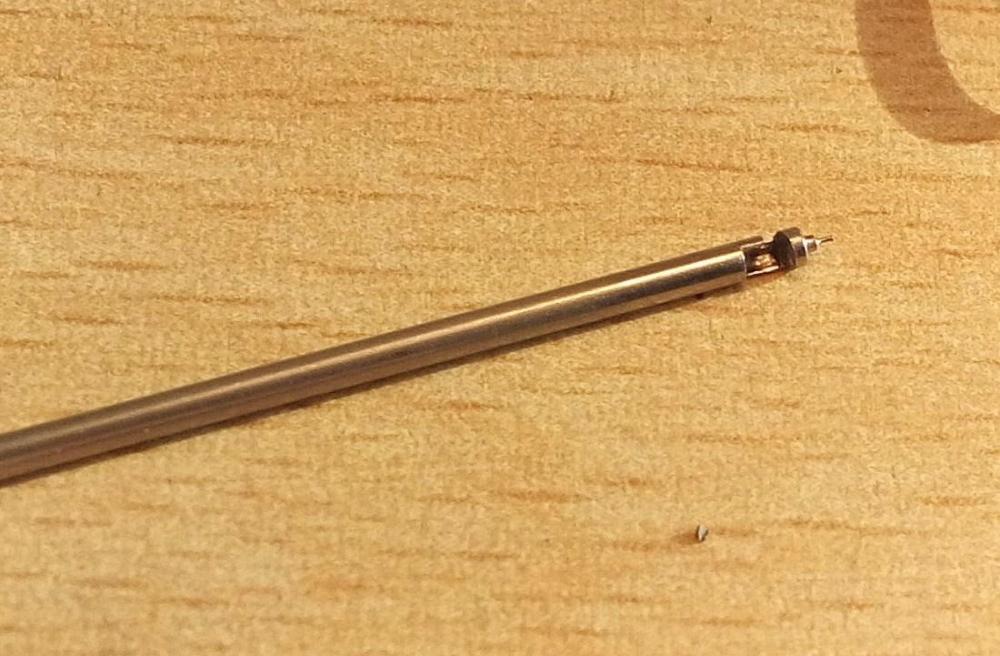

Hi Nev, no the cylinder snapped in half when i tried to push the other plug further out. I didn't have the cylinder supported well enough, i need to find a replacement hollow cylinder. Wondering if i could use a solid cylinder and cut the mouth to fit the escape wheel.
Edited by Neverenoughwatches
OK, this is cheap movement and pritty small. No worth making cylinder for it. Making a cylinder is possible and even normal routine task, but when the movement is valuable. It is beter to start practicing it with cylinder for carriage clock, which are much bigger than this one. There are different ways for making cylinder described in books, i have my own way too. Will expain when needed.
Thanks nev, i appreciate the reply, no the movement is worth nothing and i paid nothing for it. Out of my depth but it was something i wanted to try and would have enjoyed making and seeing it work again, nothing ventured nothing gained. I dont particularly want to spend too much time on it, it will sit until i have an opportunity to go back to . Lots more to keep me occupied so i can step back again to a more comfortable level for a while. I appreciate your help with it and i did learn from it and you.
