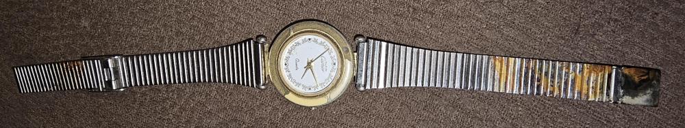

Cartier repair
Keevo, Welcome to the group ! I'm thinking that you have some damage to the hour, and/ or minute wheel. Possibly just a bent, otherwise damaged, or missing tooth. Your photo didn't post that I can see. I think you'll have to open it to start really finding the issue. Best, Randy
