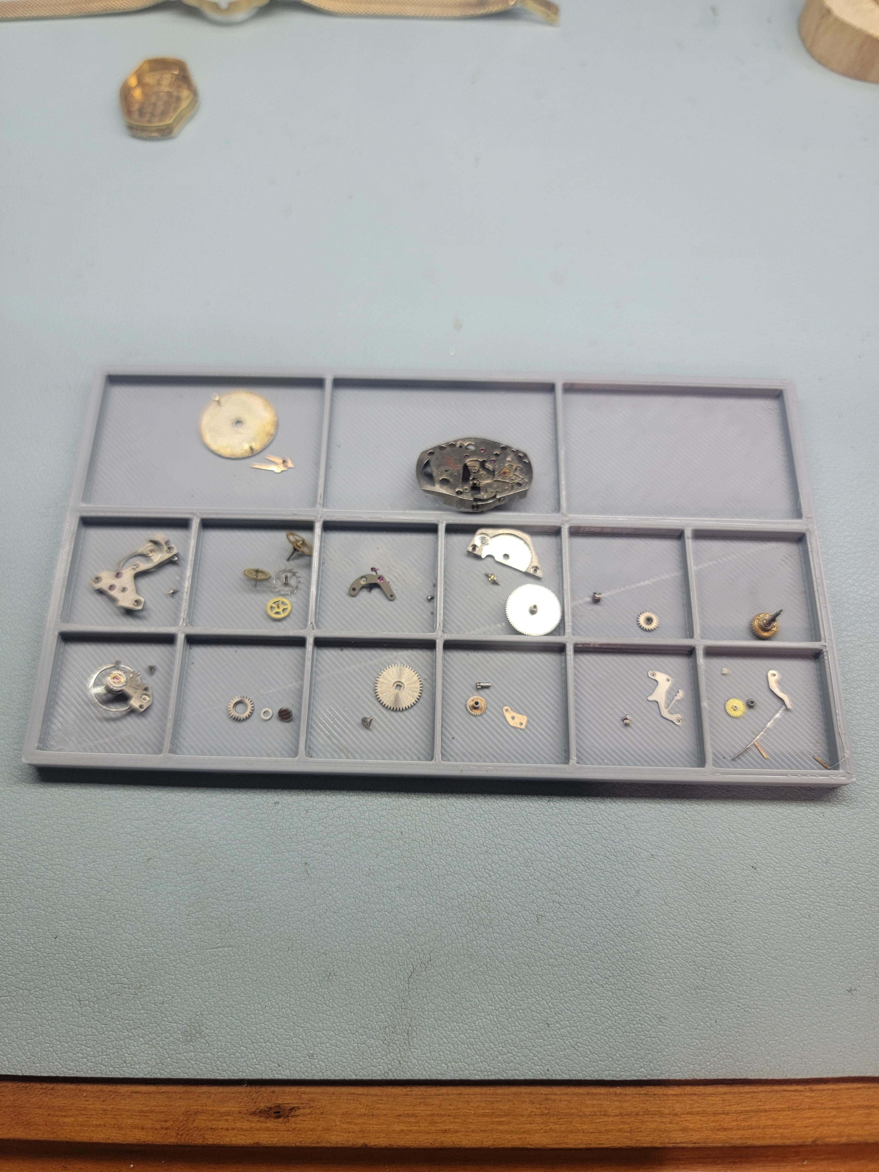

I really do not like working on ladies watches, but when a friend has a sentimental attachment...well...I guess I am easy.
This is a French watch (the owner is French) received by the mother of the owner when the owner was born back in 1960.  Never heard of Lip, but they made quite a few watches.
The service was mostly uneventful except for BREAKING THE YOKE SPRING!!!
While removing the yoke, I was pressing the spring away and it just snapped in two.  The spring design is such that if fits in a kerf cut into the main plate.  The spring is flat.  I have tons of springs (shepherds hook, etc.) but nothing like this.  So I took some round spring steel (I have lots in all different gauges) and by repeatedly placing it in a vise, I was able to flatten.  The width had to be about 0.18mm.  If I had a better vise with nice flat faces, this would not have been to hard.  As it was, it took about a half hour.  Got it!! Done.  I show the broken spring with a 50 screwdriver for scale.  Also show the replacement installed in the kerf.
Getting the timing works wheels all aligned under the plate was a little fiddly, but I managed by using a microscope.
As I was working on the spring, it became obvious why it is called "watchmaking."
