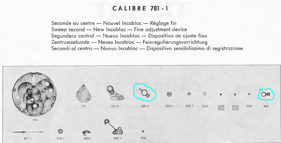

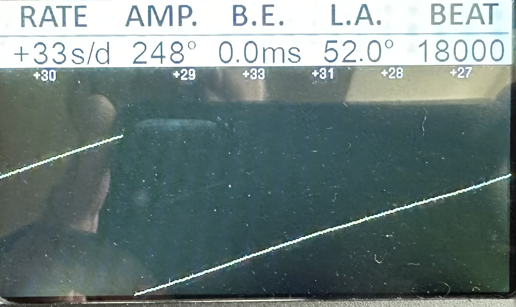

Finished my first ever service and got my dads non running Tissot working. One final question on adjustments.
Thanks Mark, but can we still discuss the other important matter please and not be distracted from it. Thank you. -
You're probably not going to see a dramatic change but you should probably figure out what the lift angle is as it probably is not 52°
