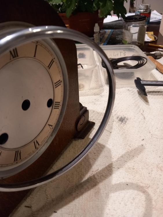

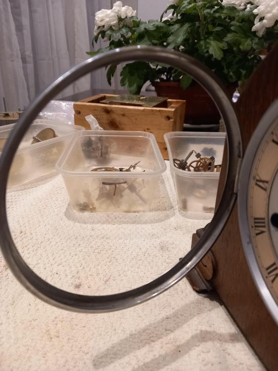

I am working on a small Smiths mantel clock and when it arrived the glass was broken (I'm not returning it because it came from the British Heart Foundation). It looks quite straightforward as there is a circular clip to hold it in place. The glass had shattered so it was impossible to reassemble for the measurements. When I measured the inside rim diameter of the chrome bezel it is 118.3mm. Cousins have 116mm and 119mm. Does anyone have any advice on ordering new glass?20240107_200450.thumb.jpg.01790f7ebd77925ae5a0a91edc4dde58.jpg
20240107_200513.thumb.jpg.84a1f44d74d05b0e9e15ab7564035ef0.jpg20240107_200637.thumb.jpg.4b01464b2e7f4b7403a339d060aca69c.jpg20240107_200656.thumb.jpg.d17408084f6b6d8adfde09497a371530.jpg
Hi Roxy. There are companies  on the net and eBay who will cut the glass to size, a bit more expensive the
an off the shelf though.  Could try A.G.Thomas  Bradford or Gleave and co.    Meadows and Passmore were. Good source but I think they only supply the trade now, might be worth looking though.
That glass is to small, the inside ring only holds the glass in, if you had the small glass with your fingers you would be able to move it about even with that ring inside the bezel. You best bet is the advice watchweasol has said get one cut to size, if you have a glazier  near you how about trying there.
Thanks OH and WW. I have a good glazier near me - I'll ask there. Unfortunately the original glass is in so many pieces it would be impossible to put it together to measure. I have told the British Heart Foundation to raise this with the courier and to take greater care with packing in future. It wasn't very expensive but that's not the point.20240106_150426.thumb.jpg.40f71e5f958f289dc8af90697be76854.jpg

Hi WW. Flat glass would be a pest, you're right, it would not shut because of the hands. If I were to order a new convex glass from a supplier, is it a good idea to go for the closest to the inner diameter of the inside rim (photo 3) or to measure the outside rim and adjust by subtracting a couple of mm? If the latter, it would be too big to slot in but I have read that by heating the bezel it will expand enough to slot it in.

Hi Marc. That's quite a collection you have there! I think the diameter is 121mm. This is the metric equivalent of 4¾ inches which seems like a standard size. That would fit snugly inside the bezel and I am sure I could manipulate it in if the metal was heated first to expand it.
If you have one in your collection I would be very grateful.
