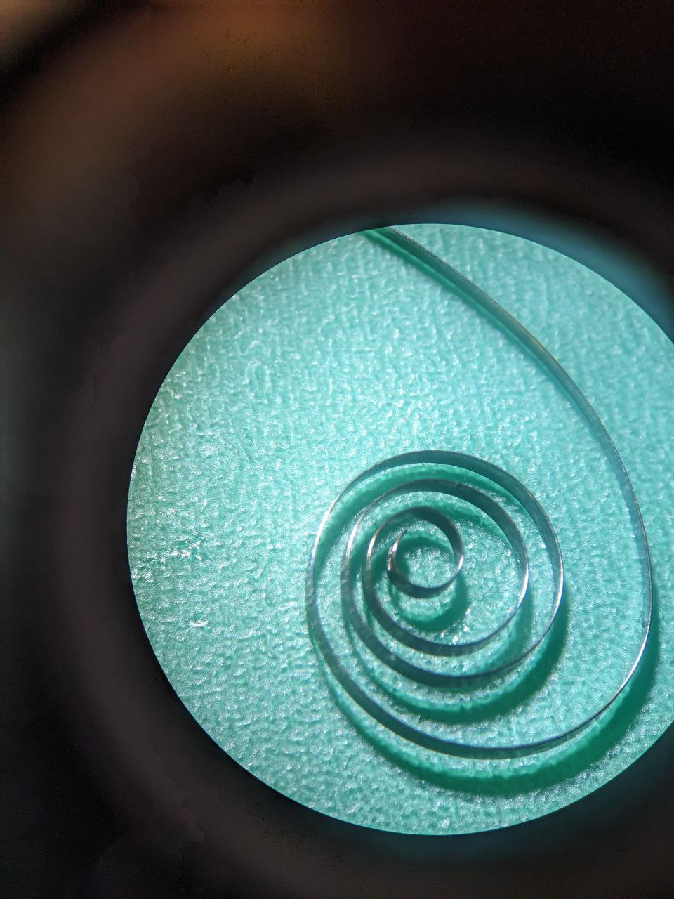

Since i can't service the barrels on the 3 watches on my "bench" i decided to jump in the deep end of fixing the alarm spring who's inner coil is out of shape and can't clutch the arbor. Saw a tutorial from my favorite watchmaking youtuber on how to anneal the mainspring to make it pliable without breaking it and it worked, i think this will be adequate.
While it doesn't make a full loop, i don't think i could have done that without breaking it the inner coil is considerably tighter than it was and i think once the arbor is in, if i can get it in it will hug it with a good bit of tension. Hopefully. I've heard from 3 people generics do not fit this particular weird arbor and NOS mainspring will be about 50 bucks which i'd like to avoid.
Next up, i wanted to make it flat as it was quite warped in the inner coils as you can see. I've never tried to flatten a mainspring with most of the twists in the inner coil and it was driving me nuts. Having it flat on my matt there were so many twists it was almost impossible to tell where they were and what wasn't making it flat and everytime i twisted something because it laid on the mat it was adding a twist somewhere else so i decided to try something smarter and made this little setup so i could see it's natural shape without it's own weight throwing anything off.
After wheel spinning for 2 hours the other way without much progress this worked REAL well! That's a pretty flat boy.
