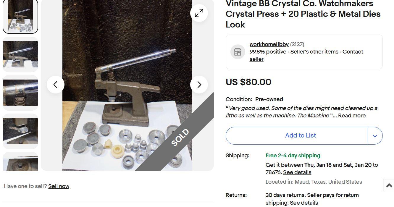

Bought this today on eBay--BB Crystal press
By luiazazrambo · Posted
