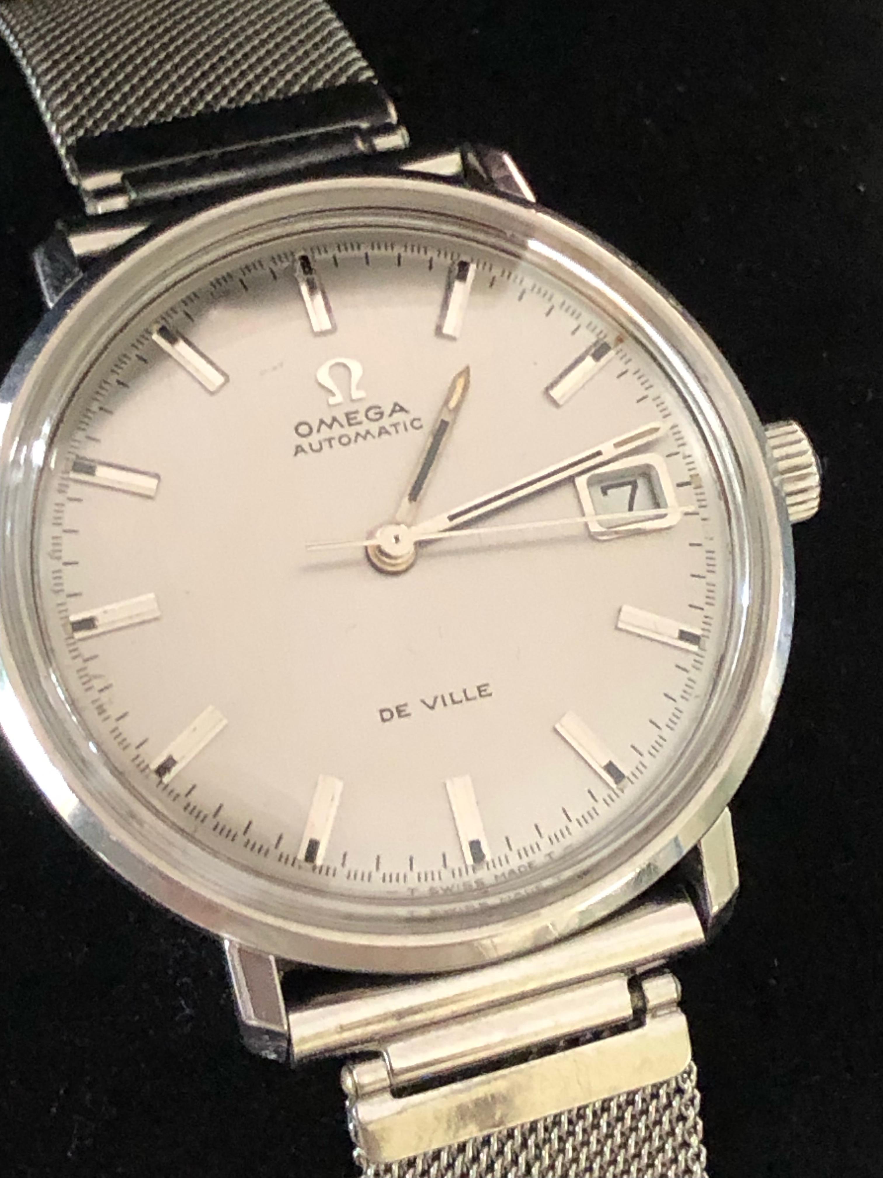

Hi All,
I am hoping someone more learned may be able to assist me in sourcing a replacement Acrylic crystal for the above mentioned Omega Deville. It was given to me to try and get going and I quickly saw that it was missing the sweep seconds hand and the hour hand is misshapen.  To boot, it looks like someone previously did not realise the watch opens at the front and gashed the rear of the case before attempting to remove the crystal by removing the crystal and not the retaining ring.....this has resulted in 3  marked chips in the plexiglass.
The rest of the watch is in good condition, movement is running ok, however I will service it as it's had dust creep in from the ill fitted crystal post damage.
I would like to keep things original where able and am unable to source parts I need for this fix with my very limited knowledge of places that one can find such things. I am aware of the Swatch Group issues with parts to suppliers  and Cousins (who I have shopped with for other parts) are showing the hands as "restricted" and not for sale to me I presume...?
The crystal CY-OM063PX5087 below from Perrins looks perfect dimensionally however the tension ring needs to be silver and not gold.
https://perrinwatchparts.com/products/omega-genuine-original-crystals-cy-om063px5087
I would be grateful for any assistance in sourcing the above hands and Crystal to restore a watch that belonged to my friend's late grandfather who was himself a watch repairer. I presume he never got around to fixing this one and it would be a treat to my friend to wear it.
Happy watch fixing everyone.
Cheers,
Manny

Thank you JohnR for your detailed advice and help with this fix. I have learned a lot from your comments already and appreciate the knowledge and assistance.
I have managed to source an original new crystal quite well priced ($70 AUD) so that part looks sorted. I will continue the hunt with the hands as you have suggested and hopefully get them sorted also.
Keep you posted.
Manny
Update - I have managed to straighten and repaint the hour hand and replace the sweep second hand with a generic from Cousins. Watch is back together with minimum expenditure as my mate didn't want to spend much at all. For info never found a replacement set of hands available, only found them in gold.
It's far from a perfect repair yet given the overall condition of the watch and the $0 willing to be spent on it coupled with my couple of months in the hobby - I will call this done.
All up the following was done:
- hour hand fix
- replacement sweep second fitted
- date corrector repaired (would not advance daily)
- quick set date now working
- crystal replaced with original
Will service down the track once i have more experience, have only done around a dozen of cheaper movements and know this will be an expensive mistake with cost of parts and availability. Watch is running fine anyhow.
Am happy that my mate's late grandfather's watch which has been sitting in a drawer for 10 years can now be worn, has sentimental value over aesthetic in this case.
