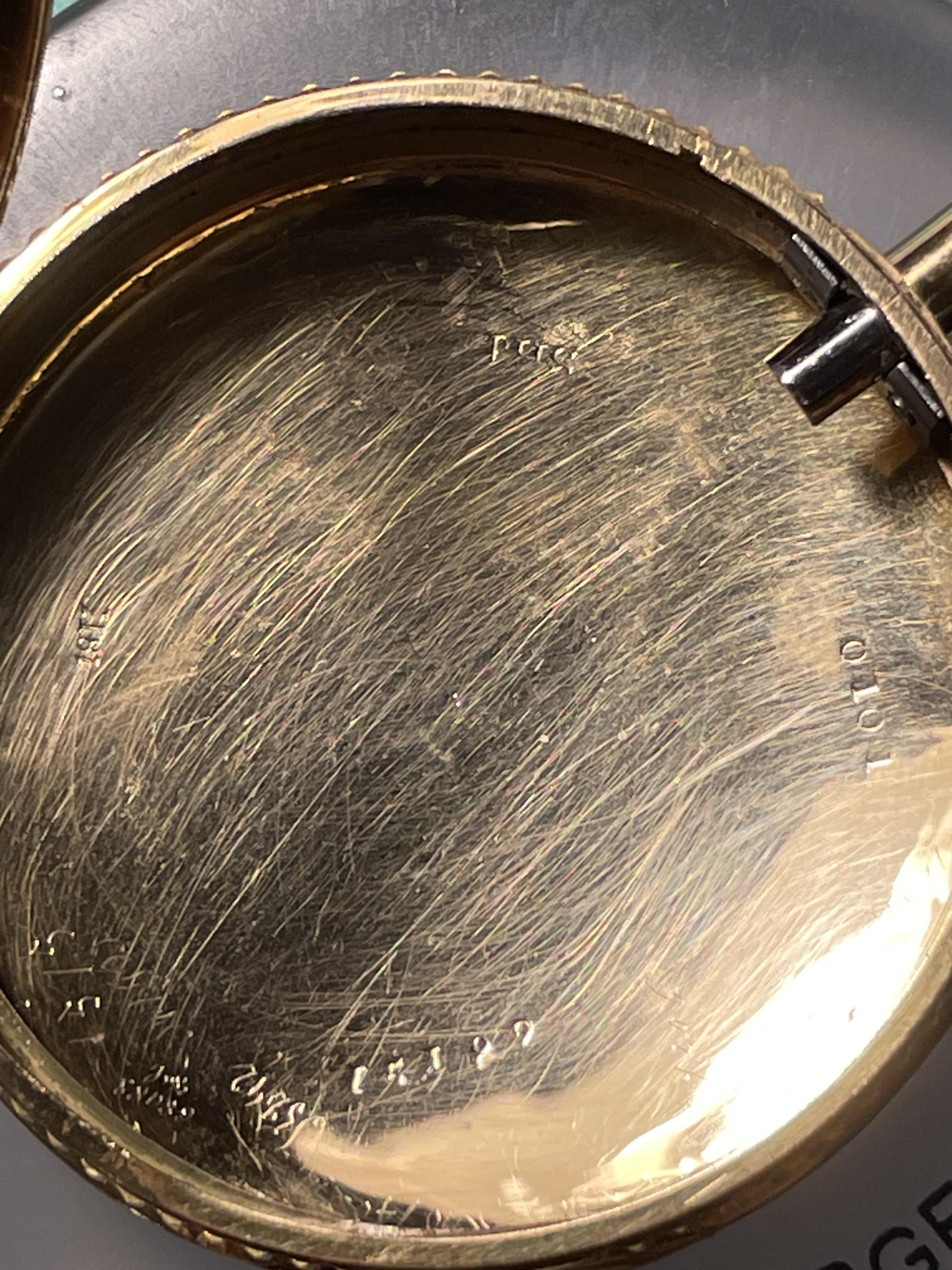

I cant identify the make as it has been difficult to find the hallmark.  See photos. I do see what could be a Hallmark but its just 3 letters "PHS". From the Hallmark Index Book the only thing I can find is "Philipp Hass & Soehne" but it doesnt match the Hallmark lettering from the book.  Any idea if that is correct?
There are quite a few watchmaker marks left on the inside case and what could be a model 0101 and serial number but not sure if this all aligns to Philipp Hass & Soehne.

Believe me, the watch is old, and has nothing to do with  Phillip Haas. The key word is not 'fusee', but 'fusee verge repeater', and the syle and the layout of the movement.

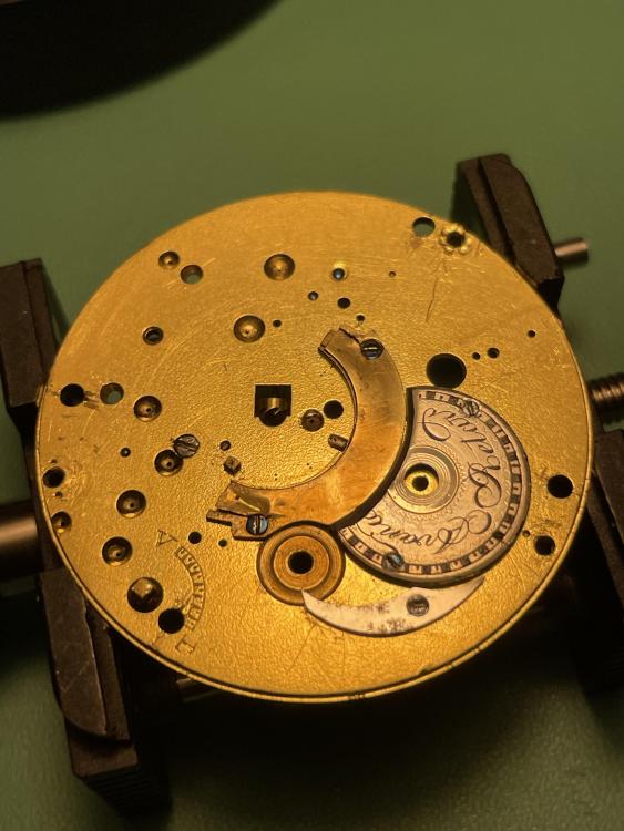

Yes, I will try to guide You thru what is needed to do in order to make all work. Please, show pictures of the other side of the plates, we need to se the condition of the crown wheel teeth, also of the repeater parts and levers, the chain...
Yes in understand why pivots break. The center wheel pivot does not protrude past the plate so the piece of spring steel lays flat on top of the pivot hole and the stone which you can see was broken is on top of that but it was glued in.  Not very pretty.
Here are 2 photos.
Curious why would there be a second adjustment scale I circled in black? Its adjustment pivot is ground off on the back so I may have been the original or the plate was used for a different watch?

The V-L scale and the square that can be turned is for adjustment of repeater speed. On the bottom of the square part is the hole of the last bearing of the repeater train, where only small pinion with no table sits. Turning of the square changes the distance between this pinion and the wheel that iti is meshed to. !!! decreasing the distance is possible beyond the point where the pointer leaves the scale and forcing in this direction will lead to breaking the pivots of the small pinion!!!

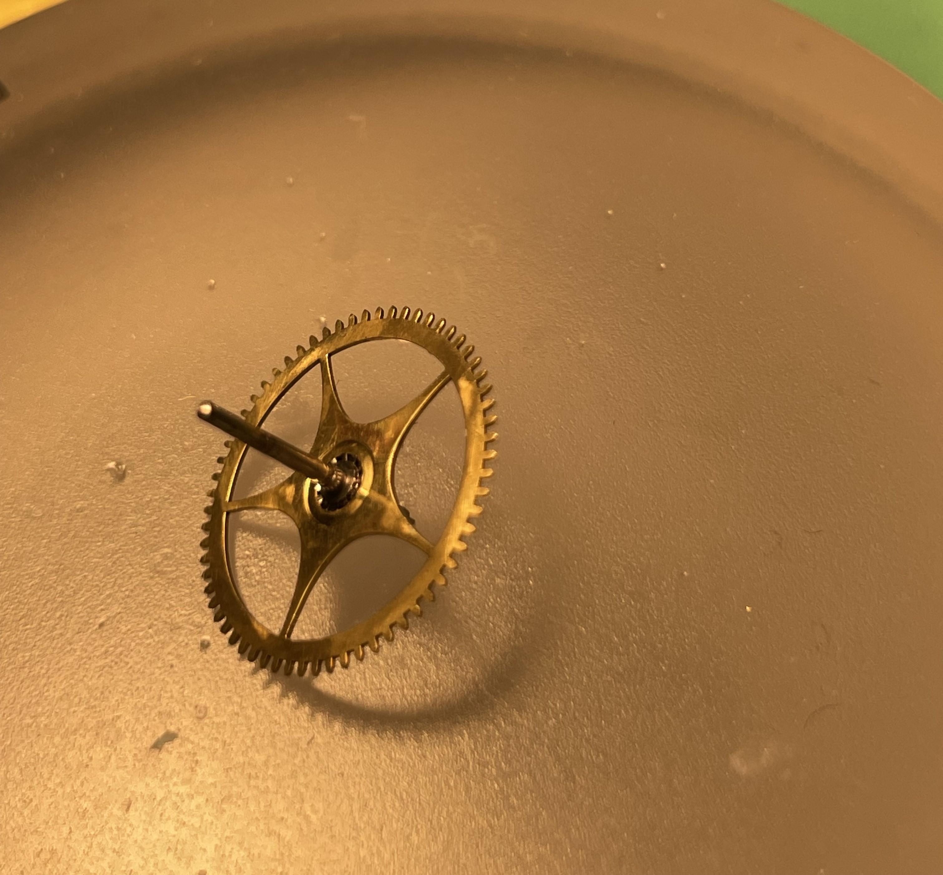

What I wanted to see is the teeth of the crown wheel. The crown wheel is seen, but it teeth are under the down side balance kock, so please make picture from another angle, that alows to see the teeth. Actually, the teeth are seen on the next picture and seem to be good.
The chain is placed on it's place AFTER assembling of the movement. It is easier to do it when the movement is assembled, but balance is not in it's place, so the train can move freely. Then, the barrel end (hook) of the chain is attached to the hole on te barrel. The barrel is rotated by wooden stick untill the chain is fully wound on the barrel. Then, the fusee end is atached to the fusee, some force is aplyed to the barrel in order to strain the chain and to let the train move untill the fusee gets to the position where the chain is strained and no more turning of the fusee is possible. Then, holding the barrel not to let the chain get loose,  the ratchet wheel is put on the square of the barrel arbor, the arbor is rotated in a manner that the spring is wound a little and will hold the cain strained, and the click is engaged with the ratchet wheel. Then, block the train and wind  the spring slowly (by the fusee arbor) and the same time observe if the chain goes correctly on the fusee channel. If needed, help the chain not to go out the channel, this is only when first winding. After that, release the train and let the spring unwind by train turning. !!!All train bearings must be oiled!!!
Edited by nevenbekriev
We have differences here in terminology...
What You show last is the center wheel, also called 2nd wheel. Center  as it stays in the center, the minute hand is on it's arbor.
The Crown wheel is actually the escape wheel in verge escapement. It is shown with arrow in the pictureIMG_54402.thumb.jpg.be64f28a016b63d318781f5b16a9f93b.jpg.e8c8593d7ab6c2a6b108063e67930e2f.jpg
And what You seems to call central wheel, is actually the balance. The balance staff in this escapement is called 'VERGE' or in German 'SCHPINDEL'

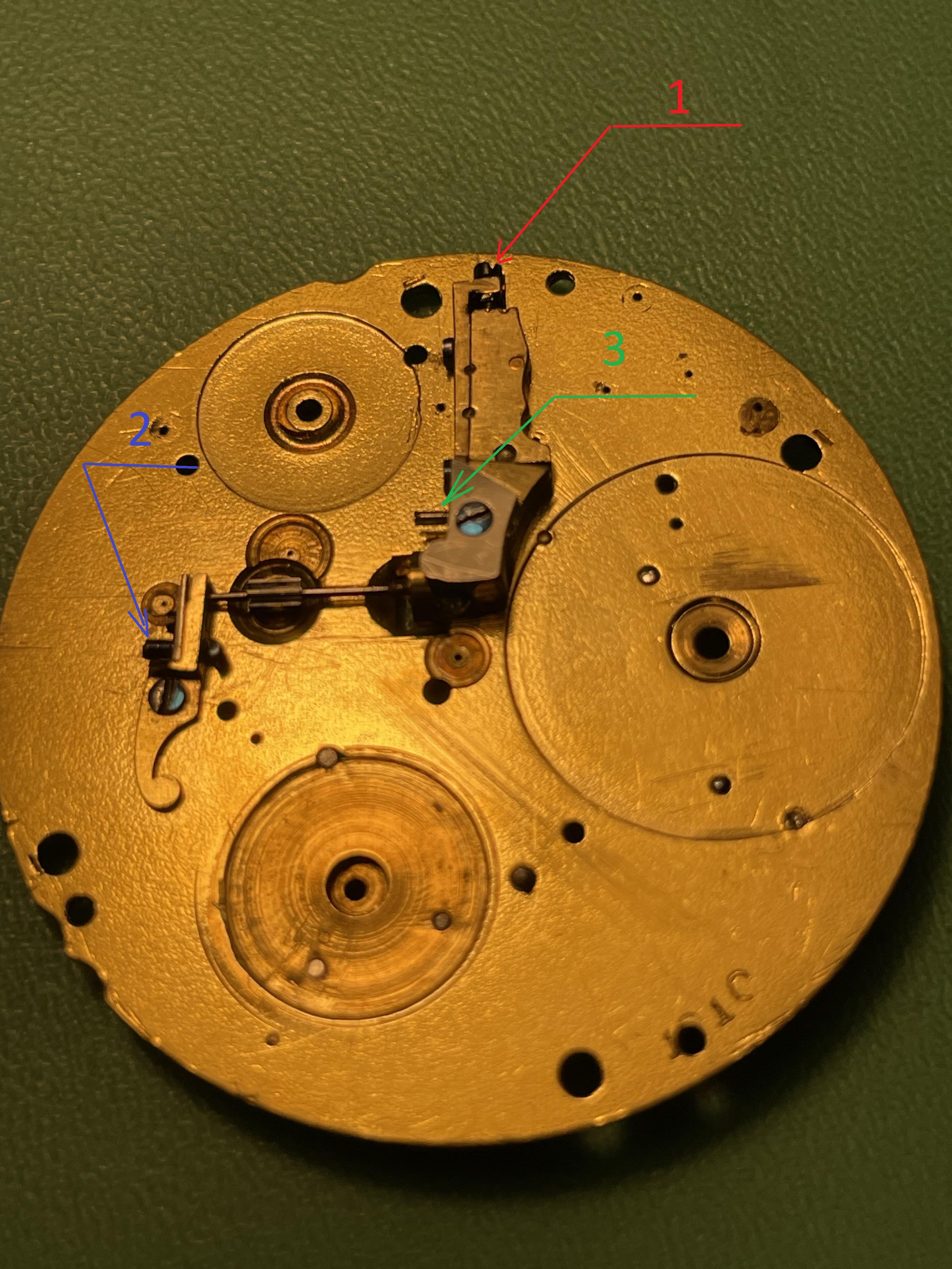

I didn't have much time this days...
IMG_5441.jpg.ab3c8dd344536ca7743555ce06769d21.thumb.jpg.b6dfc9555e25af235814b49242b6495e.jpg
1 is for adjustment the crown wheel position.
2 i sfor adjustment of the depht of the escapement.
3 is for adjustment of crown wheel axial free play, after 1 and 2 adjustments are done.
The screw 2 can only move the rear bearing of the crown wheel back from the verge, thus reducing the depth. Increasing the depth is by unscrewing 2 and then pushing the bearing to the verge
Here is a graph that represents the adjusment of 1 and 2.
When moving the crown wheel relative to the verge by 1 There will be areas where turning the crown wheel will make the verge oscillate (the triangels), and areas where the verge will block the wheel and the escapement will not work. The blue line represents the minimal depth - under it the crown wheel teeth will not rich the flags of the verge and crown wheel will rotate free without making the verge oscillate.  The closer is the crown wheel position adjustment to the orange central line, the more deeper is possible to mesh the crown wheel to the verge and still escapement capable to work. The idea of adjustment of 1 is to find the position where maximal depth is possible. Then 2 is adjusted almost to maximal depth and a little back, to ensure reliable work. The black dot on the graph represents the best adjustment of 1 and 2.
If all is perfect - the flags of the verge are equal and the angle between the vege and crown wheel axes is 90 degr., then the correct adjustment will be when this axes are in one plain. In real life, the best escapement adjustment is close to this, but may differ and needs to be found in experimental way.
Onse 1 adjusted when manufactured, a mark is placed to make further works easier. But, if the verge for example is replaced, this mark is no more that relevant, just as ball park may be used to find the best adjustment close to it.
3 is to be adjusted after 1 and 2 are done, in order to make the axial free play of crown wheel minimal

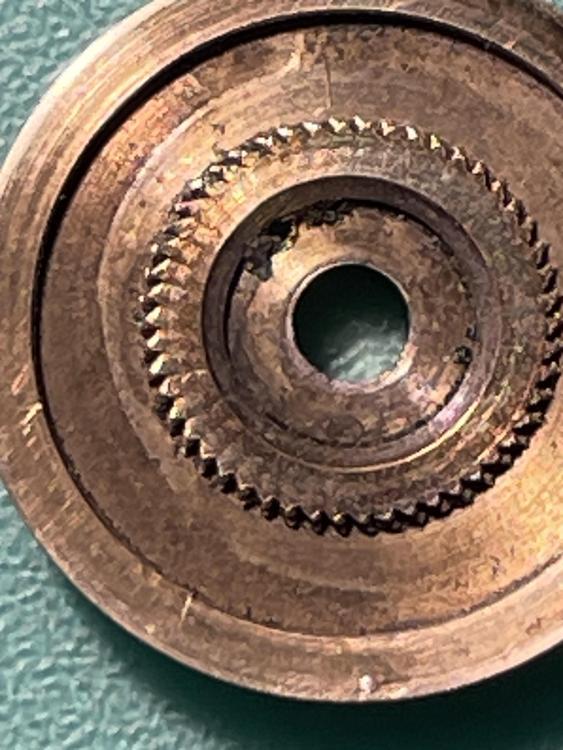

One thing I found when I put the fugee and barrel in and installed the chain and attempted a small wind to get the chain on.  Fugee was partially slipping.  I opened it and found the click had chipped and winding attempted many times to cause bad wear on the ratchet teeth. So I remember your words in your first pots "there are no spare parts".   All I am looking to do is just get it running, not a full restoration.   I may be able to get the ratchet to a running state with some gentle filing and can look to make the click.
Thank you!
Bob

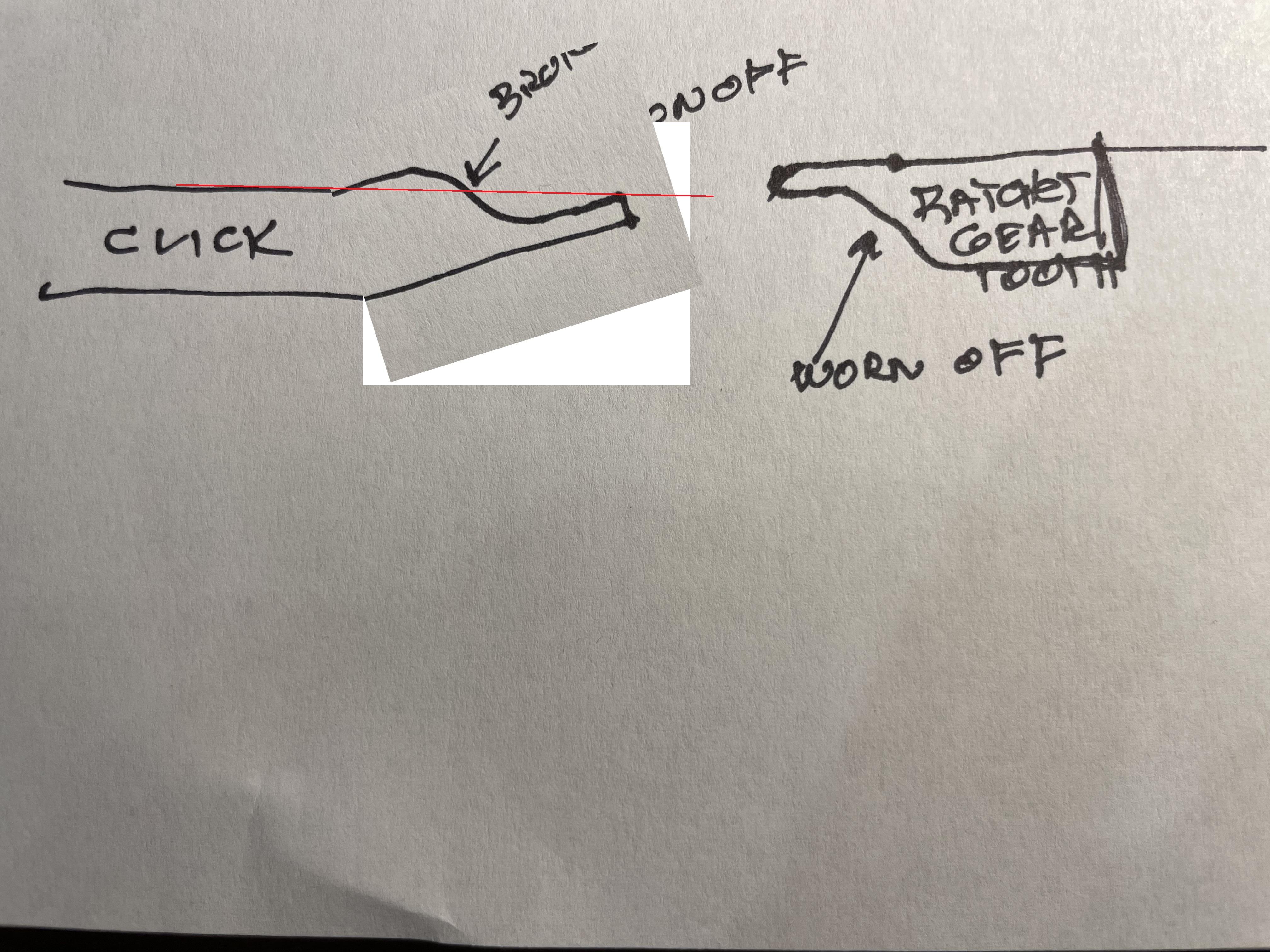

Sorry to see that. Actually, will not advice to touch the ratchet wheel. You can work on the click only and it will be possible to solve the problem by bending it a little in a manner that it's tip gets lifted above the surface of the table Thus, it will be able to catch the part of the teeth that is not damaged The tip of the click is smashed, but it is soft and will be possible to form it right onse it is lifted. Lifting must be done without damaging the rivet of the click, so no force to be aplied to this joint. Put sctewdriver tip under the tip of the click to get it lifted as much as free play alows and then press the midle part of the click, this will bend it in needed way. The table should stay on flat hard surface.
Neven I followed your advice and was able to bend the click enough to have a positive effect.  I holds much better. Not 100% but I think I know when to not push my luck.  There are a few teath on the ratchet that are worse than others and  still cause it to slip if you push it.   I am doing it by hand and not sure yet how the strength of the mainspring will play against it now.  But it feels like there is enougn hold to get it wound.
Thanks
Bob
There must not be turning back, this is not acceptable. The tip of the click must be reshaped/sharpened, may be the spring to be bent to  press the click further down, do the click go down free enough?
I understand, no guts no glory.  I went a bit further with the click but it is as far as a can go.  I bent the click spring to apply a bit more pressure.  The way the click was damaged on the top, and the ratchet on the bottom (when in place) really prevents me from reshaping it without losing too much material.   See the drawing I attached.  Given this I cant sharpen the click any further without shortening it.
It is still skipping on some the most damaged teeth even with all the adjustments.
I have no alternative if I go too far and break it.  I can probably make a new click with lathe and file.  I have the lathe but not the mechanics necessary for gear making.   But there is even risk for me to remove any of these pieces.
So I will have to leave it unless someone knows where I can get these 2 parts removed, made, and installed.  I now it is terrible, but risk is too high for me 😞
I see it clealy from the pictures of the parts. That's why I adviced to bend the click. I ment this way:
IMG_5508.jpg.56c64f0d59cb822c6b255ead25373947.thumb.jpg.2bf6ed149902101b9e24fa579582cdc2.jpg
Then file all above the red line.
If You have lathe, then it shoild be no problem to make new click, this is simple.
