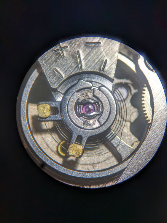

I feel like this is pretty damn good for this movement? I got a delta of 6 on this same 7s36b before it took a dive on concrete and broke. Reshaped the hairspring and reserviced it and this is what I got now.  I've only done two hairspring jobs but this one was utterly trashed from the fall and i got it i think about as close to perfect as i could.
I'm curious because I have a couple people from watchuseek basically begging me to service and adjust their 7s26's and offering me decent money to do it because they can't find a competent watchmaker. I"m just a hobbyist but i'm thinking of taking them up on it as i get results at the very least far better than the factory after my services on this movement.
The rebuilt hairspring in case there's any room for improvement and the watch in question because we all like watches.

All looks good, just to give you a yard stick and put things into perspective I think the rate on a new Seiko is like 20 seconds/day (someone correct me if I'm wrong), so you are better than factory spec in all orientations. Like the finish too, all edges are still crisp and not over rounded/ over polished. Especially like the red seconds hand. 10/10 with a gold star ⭐

All my services have been exponentially better than factory specs. I guess what i'm curious about is how my service stacks up to a professional who was just doing a basic cleaning and service of this movement. the professionals elsewhere i hear keep saying basically seikos are crap, the amplitude is 240 on a good day and i consistently get into the high 270's to low 290's on them.  My oldest service is something like 2 years old now and it's still running well over 270 So i feel like i must be doing something right.
As for the case, i never polished it. that's probably the next thing i'm gonna try to learn as all my cases could use it, that's the factory finish plus some swirlies and some unfortunate dings from the fall.

Yeah, for a first paid gig I think the minimum is reasonable, at the same time i'm not entirely sure how the service you see there would stack up with the results a professional would get. This isn't exactly a high accuracy movement and i feel that's a solid timing.
28 minutes ago, Birbdad said:
…i'm not entirely sure how the service you see there would stack up with the results a professional would get…
Are you kidding? Most of us have seen results provided by so called „professionals“. You are more than competitive!

Well that's good to hear! I just keep hearing form professionals what crap these movements are and i'm thinking "I keep getting REALLY good results out of them..."
…this has been my observation as well. The ‘crap’ part often is referring to lack of finish or economical fasteners and shortcuts. I’ve had many that adjust well in positions, like yours…
