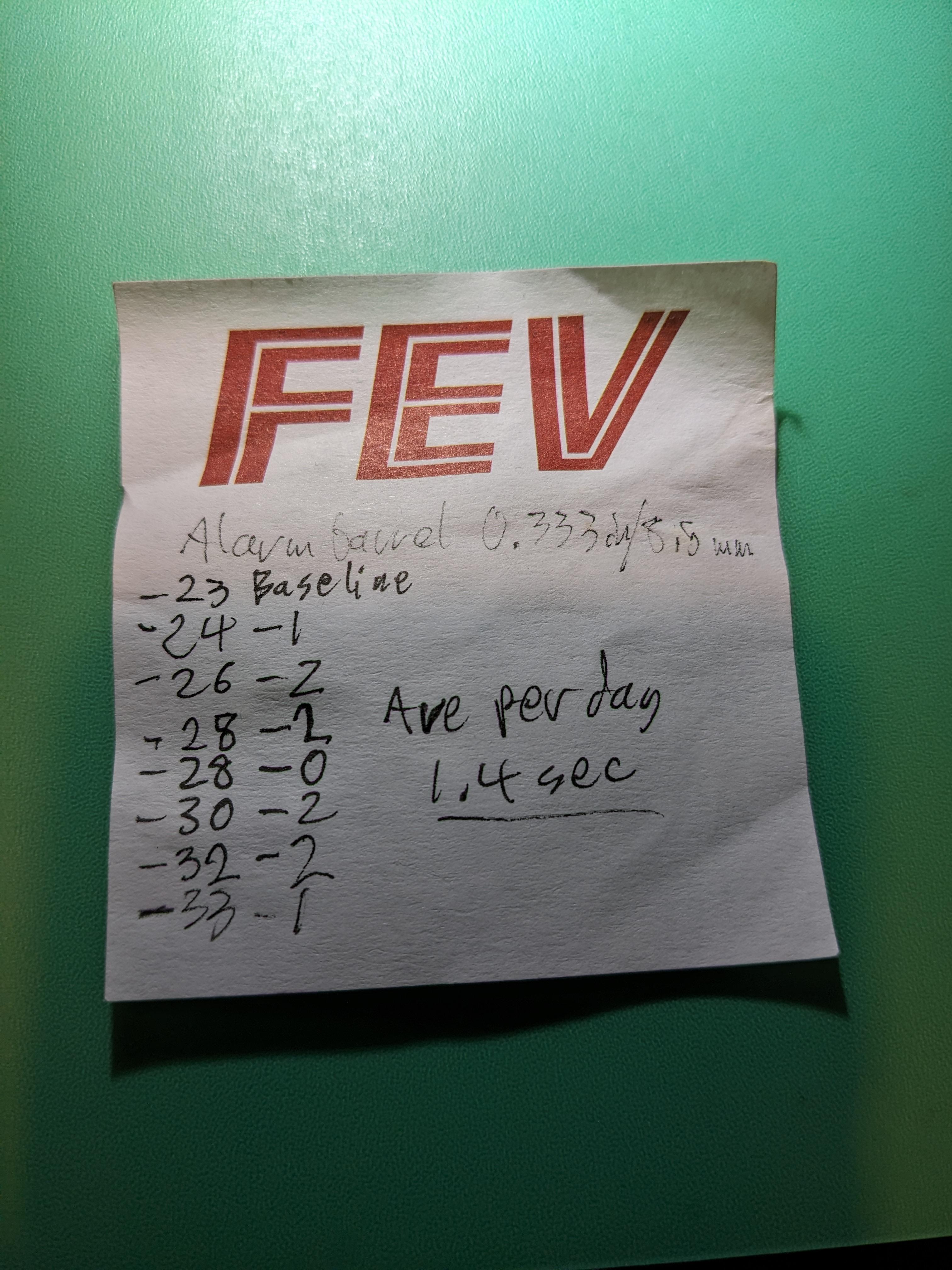

Ok i just finished my first paid gig and here's the results. This is after running for 2 days. First check is one hour from full wind and second is 24 hours running, isochronism achieved. The only thing i find odd is i couldn't quite get the amplitude to over 270, not that it has to be. This watch has run for 15 years without a service and got knocked so hard it stopped working hence why he paid me to repair it. This may have some wear keeping amplitude a bit lower than i normally get. ALso this is the first time using my new oiling method i properly oiled the 3rd wheel with hp1300, I'll be doing investigations on this to see if that thicker oil there lowers the amplitude a bit as this is not what seiko recommends in their service sheets.
I think these are pretty damn good results regardless right? Movement is 7s26c from a seiko skx007
Edited by Birbdad
Hi. They look very good . 1. It’s up and running.  2 it’s keeping good time .  That’s all your client wants, no confusion over technicalities. Good job.    Any heavier lubrication will have an effect on amplitude  but it’s the time keeping that matters. Nice one

This whole thread was trying to guage the quality of my service to see if i was fit to charge money for it haha. Thank you for giving me an answer.
The lubrication thing is interesting. I'm about to service another 7s26 when my mainsprings arrive from cousins and i will be real curious to see if i again get a bit lower amplitude lubricating in the same fashion.

Looks good Col, you should be pleased with it.
Thanks bud. So this is more or less basically what i got the last two services i did before this as far as a really low delta and accuracy.
Makes me wonder if this is the mechanical limit for accuracy for this movement because before my results were a bit all over the place but still better than factory. Now my results are much much better and pretty dang consistent. I really would be curious what a top tier watchmaker adjusting and servicing one of these would get, if it can have a little more accuracy squeezed out of it in a basic service.
The more of them you do, the more you'll get a handle on how far they can go. I suppose there will be a few that under perform and a few that will over perform no matter how well you've serviced them . There's always going to be other little things going on due to wear and tear or just production line Friday watches that are out of your control. But every one that you've done up to now has come out great.
Hi @Birbdad don’t sell yourself short you are a capable watch repairman no doubt. I would have no hesitation in using your services or recomending them based on what you post. I think your quality will speak for its self. Just be straight up with your clients and tell them as it is no flannel.

Not sure i've earned the title as watchmaker yet but I think on the movements i'm comfortable with i would put my services toe to toe with any watchmaker.
And i'm very straight up. I would love this to become a little sidegig which could greatly motivate my speed as that's currently my biggest problem servicing watches. I take too damn long at it haha.
Thanks for the vote of confidence. HOping he likes having the most accurate 7s26 he's ever seen (If it's anything like my other two where i got the delta that low this thing should keep within about 2 seconds variation a day on the wrist.) and tells his friends or posts about it on watchuseek. Gonna put in my sig on there that I am willing to service and repair 7006, 7009, 7s26 and nh movements.
