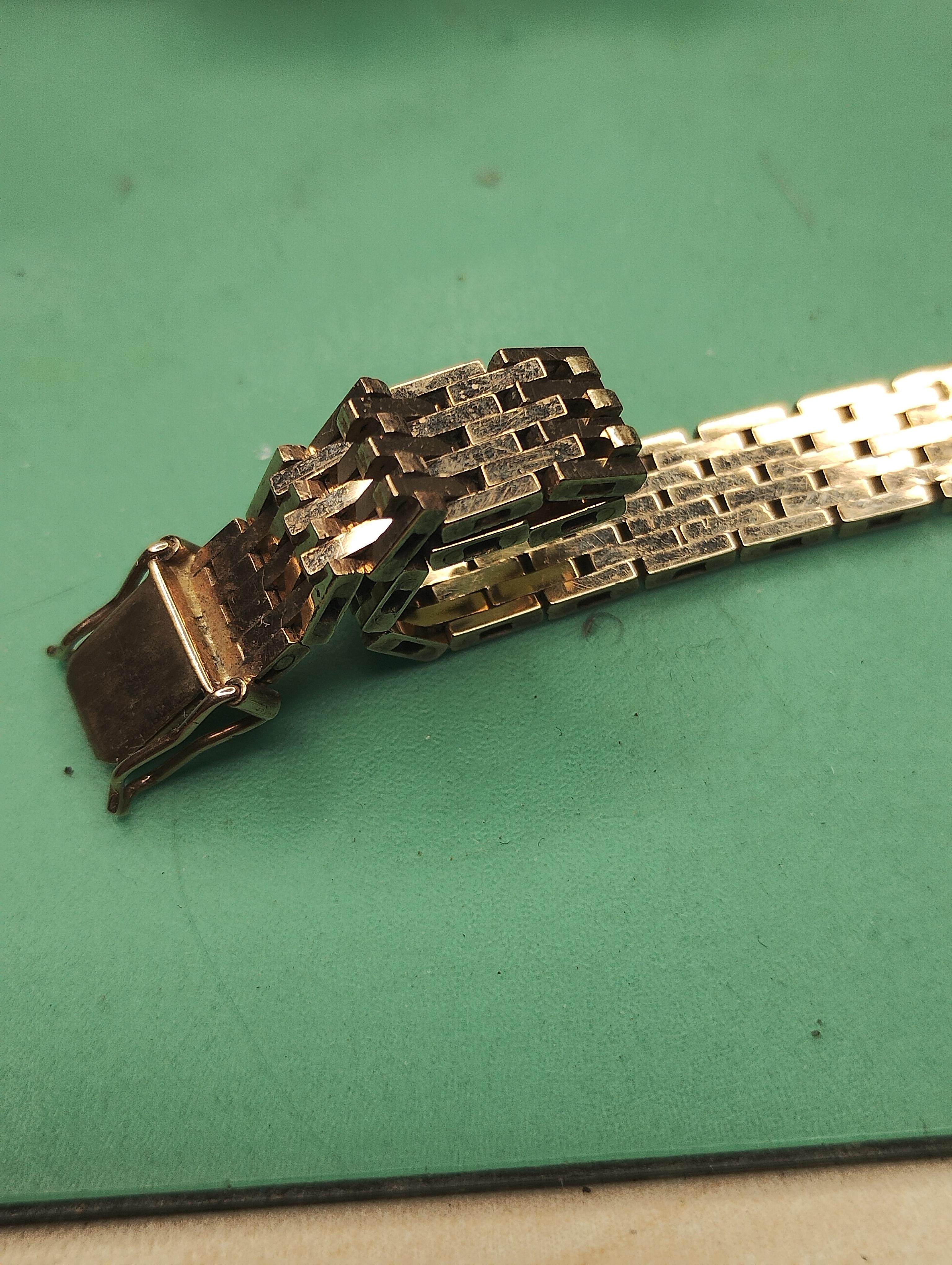

Hi. As you have already been advised you are going to have to gain access to the pivot pins by removing the infill, boy either drilling carefully. Probably best left to a jeweler who is likely to have the right tools.
