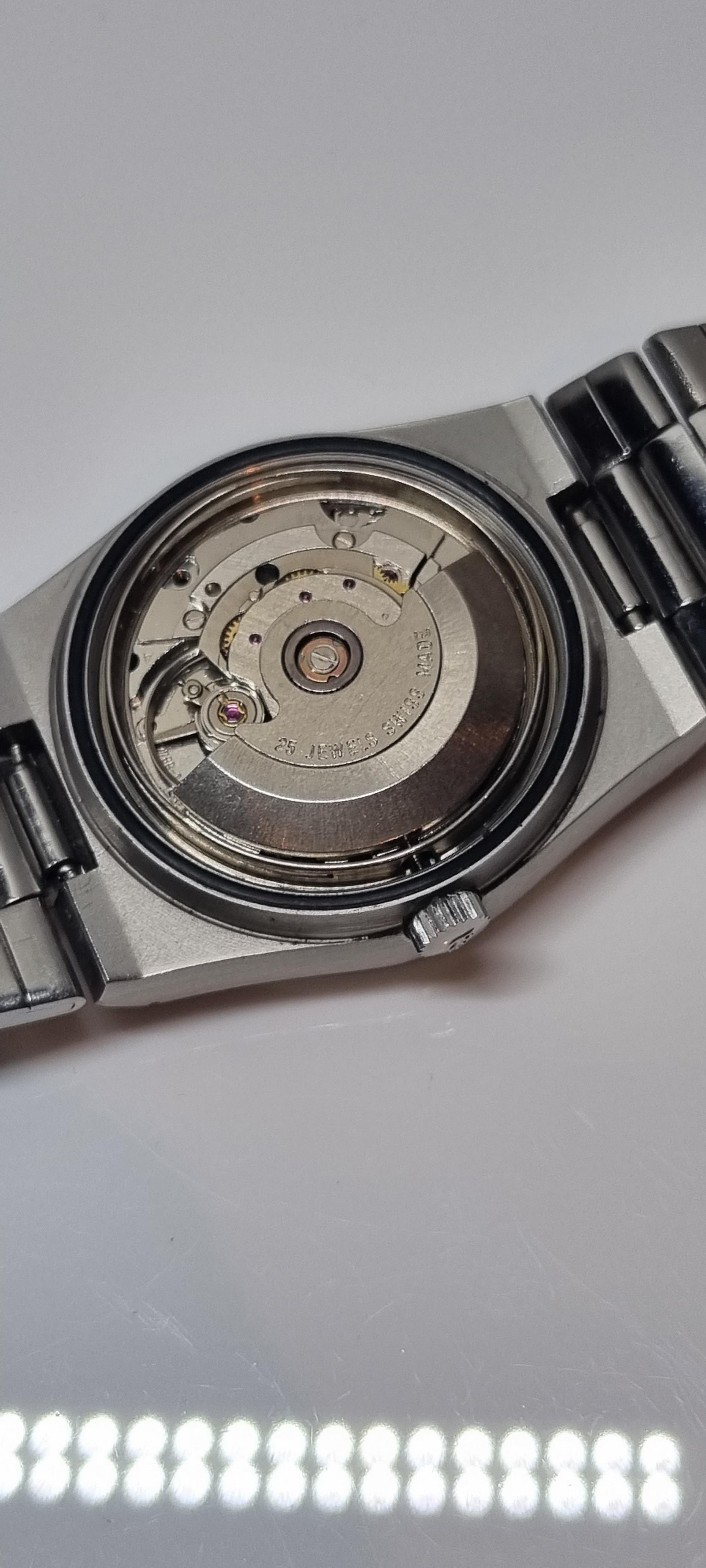

Hi All,
I've come into this, very nice it must be said, Nissen automatic watch. I have never heard of the brand nor can I find anything about it online. As in, absolutely nothing!
Is anyone any the wiser?!

It could be a watch from Nissen Holdings Co. which operates mail order companies, it tells what movement it is under the balance, I see it but can not read it all....looks to be an ETA make

Looks like an ETA 2789-1 movement. Don't confuse it with the ETA 2899 which has a different Day/Date calendar configuration.  Plenty of Youtube videos available. Take your time. Watch the videos. Done 5 now.
Have attached the ETA 2789 tech sheet. Could not find a ETA 2789-1

I think you are correct @rossjackson01, there are markings under the balance but I can't quite make them out.

    • The ones I have opened also do not have a pry point , hence the reason for the tool. The watch is clamped in the tool and a blade is screwed into the seam, the blade being chamfered lifts the back then the screw shaft is turned and the back comes off have a look on Ali express for case back removal tools

    • It's an exhibition back so no access as you suggest.
    • I have no experience with this watch, but looking at the pictures from the ebay listing linked above, it looks like the outer metal bezel at the back of the watch may not be part of the case proper.  It looks like the watch and strap are sandwiched together, and an inner case may push out of the rear bezel towards the front of the watch.  A case style similar to the Roamer watches where the crystal, movement and caseback pushed out through the back of an outer bezel, only in reverse - this one may push out towards the front.  To test this, you would need to hold the watch, dial down, supporting the dial side of the watch around the edge of the bezel without touching the bezel itself. Then push down carefully on the inner metal ring you can see at the back of the watch. I’m speculating here, proceed at your own risk. Hopefully someone with hands on experience of these watches can chime in! Best Regards, Mark
