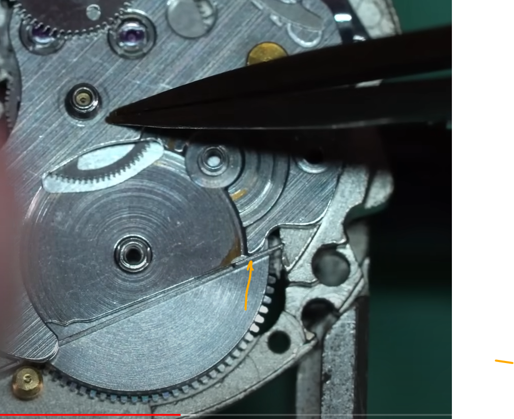

So, I partially disassembled the movement just far enough to get the new mainspring barrel I ordered in plus I removed the balance to keep it from getting damaged.  I made a rookie mistake when doing this in that I flipped the watch over to look at something on the dial side and 4 parts fell off , which I determined to be the old barrel, the clickspring, and the 3rd and 4th wheels.  So, I didn't get to look at where the 3rd and 4th wheel were seated.  I finally figured this out and got to the point of replacing the train of wheel/automatic works bridge.  So far so good.  But I couldn't get the bridge to seat fully at all 3 screws.  Whichever two I got to seat, the 3rd one wouldn't seat fully.  So I removed the bridge and was making sure all the wheels would turn as they're supposed to.  The 1st, 2nd, 3rd, and 4th wheels all turn but the escape wheel doesn't.  I noticed that the pinion gear of the escape wheel isn't held in place at this point.  When the 4th wheel turns, the pinion gear just kind of moves to the side, out of contact with the 4th gear teeth.  Is this normal?  Do I have to get the bridge seated for that pinion gear to be held against the 4th wheel?  Finally, with the 4th gear removed should I be able to turn the escape wheel or does it depend on it's pivot being held?  Thanks for any help!
Hi. A bit of a pickle indeed.  Thing to do is back check what you have done so far , then dismantle it again noting where the parts come from , take pictures,  check the plate filling without the wheels, check the wheel pivots are intact as clumsy fitting can snap them off very easily, in your case inspect the escape wheel pivots closely then re assemble carefully.  Parts/data sheets can be found at CousinsUk material house under documen5 downloads.
What scares me is the statement "I couldn't get the bridge to seat fully at all 3 screws." You don't seat the bridge with the screws, you secure the bridge with the screws once the bridge is seated and all pivots are in their respective jewels. Trying to tighten the bridge screws when the wheels aren't turning freely is an invitation to a broken or bent pivot. You might want to take a close look at the escape wheel because that definitely should engage with the 4th wheel when seated.

What I did was screw in all 3 screws, slightly.  Then I would lift and lower the bridge and check to see if the bridge was properly lowered in to place.  I could never get it in what I considered a fully lowered position. Of course, there's always the possibility that I am  too cautious in what to expect.  But I'm not willing to try to screw it down at this time.
It's a good suggestion to remove the 3rd and 4th wheels and see how far down the bridge goes.
One thing to check is if the click is wedged under the bridge. It should be outside the edge. When I first started, I had it caught under the bridge and took me a while to find it.

The click trapped under the bridge issue got me a few times when I was starting out. I also struggled with the tiny diafix cap jewels.
Bingo JackH.  I had just come to post that it was fitting down now and all I could figure was that I had the click under the bridge.

I am happy to be able to help. This happened to me too. I finally learned to pull the click aside slightly while installing the bridge.
