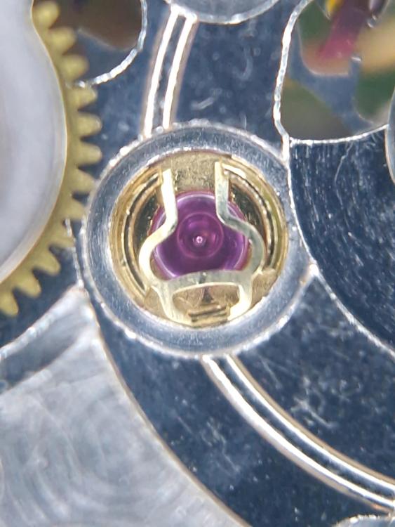

2. There might be something going on the the escape wheel or its capped jewel settings. See below picture. Notice how the oil circle is not fully central compared to the pivot? Strangely, this is the case on both sides/jewel settings (dial side and train side). I meticulously re-cleaned the setting on the dial side (cleaned every corner with pegwood etc) and re-oiled. Still same odd oil circle.
Does the cap jewel not sit evenly? Would that cause the problems I'm seeing? Or is this within normal margins?

STILL, what do you think about the non-concentric oil circle on the escape wheel jewels? And do you think that the difference in amplitude between vertical positions (with the worst being Crown up) point to something?

Does anyone have any thoughts on the below picture, though?

Another follow up on that potential issue with the escape wheel jewels:
the non-concentric oil circle is observed on BOTH sides. See the below two pictures. Both pictures are taking in such a way that the "perspective" is the same = the pallet fork and balance wheel are located above at 12 o'clock.
1. train side
2. keyless/dial side

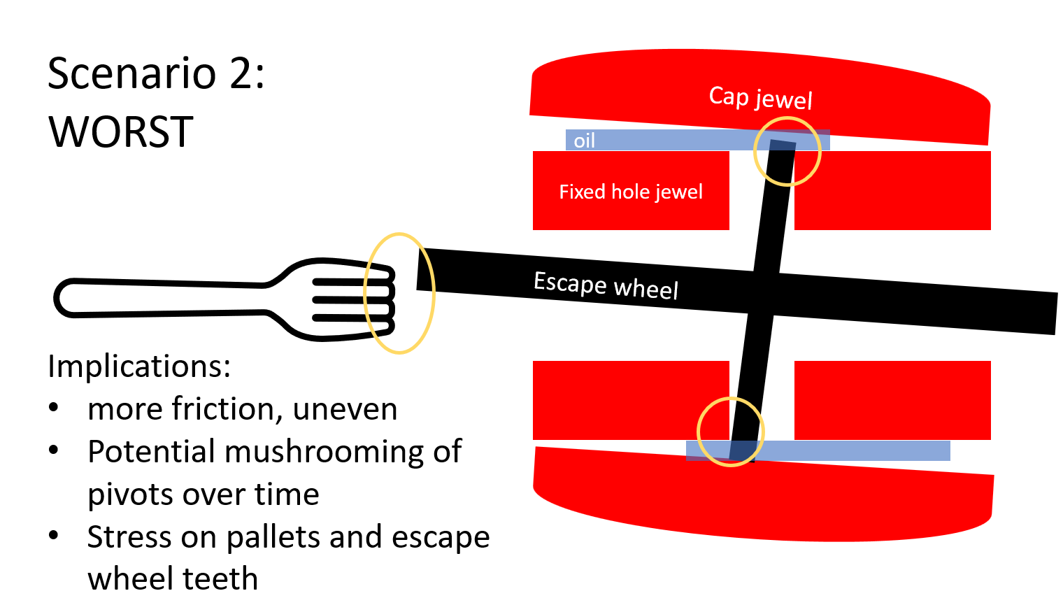

Now, let me try to visualize my thinking of what this may imply (please excuse my mediocre graphical design skill and my apparent desire for a good burger for dinner):
What do you think? Am I over-thinking? Have you ever seen anything like this?

Ok so before i get involved,  can i just say that this last picture looks like a jewel burger, i mean there's even a fork to eat it with.

For starters that endshake is unlike anything I've seen before and the balance is missing all of its components, and that pallet fork well thats completely in the wrong position. Believe it or not unbeknown to this discussion group i have actually been helpful today in other ways elsewhere .

Not sure we're understanding each other here. The drawing is of the ESCAPE WHEEL and its jewels, NOT the balance. The Rolex escape wheel has capped jewels and shock springs. That's that I'm talking about.
The jewels on the balance have perfectly concentric oil circles.

Your oil concentricity on the escape wheel isn't robbing amplitude.

Eating burgers with a fork notwithstanding, here's what i think. The location of the oil droplet is for the most part a function a combination of surface tension, capillary action and where it's initially placed. Your diagram @Knebo is not taking into account the shock spring or the chaton. So let me provide an upgraded rendering.
The lower jewel is fixed in the chaton while the upper shock jewel sits within the chaton, but not in direct contact with the lower jewel. The pivot end should not exert any pressure on the upper jewel and the downward force of the spring should keep the gap uniform. As long as the bubble of oil is surrounding the pivot and not extending to the edges of the jewels (too much oil) then you're okay.
The only way your second and third scenarios would be possible would be if the cap jewel was the wrong size or the chaton was bent or damaged. (or you dropped a bit of mustard in the hole while eating a burger with a fork).
1. train side
You for sure are over-thinking. There is no problem with the esc. wheel bearings. The actual picture is different thow, the hole stones have convex outside surface, and the direction of oil drowing is actually to the other side than in the pictures. If something is really tilted there, it is the hole stonses, but it is not of any significance. The effect that You are trying to describe with the 'scenario 3' actually does not exist.

10 hours ago, Knebo said:
Exactly! That's my "theory". However, I really cleaned the setting and don't really see how/why the jewels wouldn't be flat on each other.
What if the bottom holed jewel is not straight within the setting, in technical jargon, squiffy. Maybe the jewels are not perfectly manufactured ?
Thanks for your illustrations. I just tried to keep it simple (and I was lazy, drawing this up in Powerpoint...).
Indeed, my worry goes mostly in the direction of your quote. I've cleaned it meticulously to remove any "mustard" :-D. Size-wise, the cap jewels fit perfectly into the chatons. It's weird, though, that BOTH jewel setting exhibit the exact same symptoms. If it was something bent or so, I'd expect this to be the case on only one jewel setting...
I was afraid that might be the case. Rather than a manufacturing error (at Rolex?? 🤣), I was afraid that it could have shifted through any of my interference -- but I can't really imagine how I'd have done so.
But happy to hear that this wouldn't be too dramatic.
