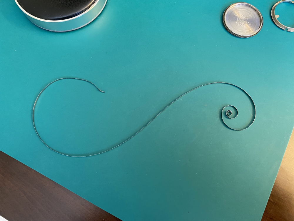

Next big decision I have is do I try to manually re-wind the main spring or buy a new one... Learning a lot as I go.
19 minutes ago, RichardHarris123 said:
What condition is the old spring in?
Well to be honest, its the first time I've even seen a mainspring in real life so I don't fully know how to assess that 🙂
It looks clean and the curves look smooth to me:
After posting that picture I realized I made the rookie mistake and took out the spring before I made a note of the rotation direction. Anyone have a suggestion for figuring that out?
Awesome thanks for the tip on the spring. I inspected everything during the disassembly and my only thought at this point is that its really really dirty. I should have been more thoughtful and tested functionality of each wheel during disassembly. I was super excited though! lol

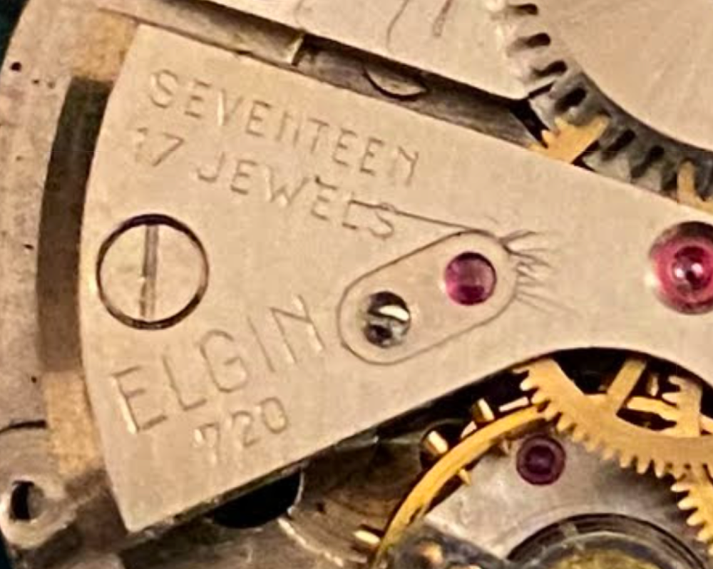

Unfortunately, it seems that elgin used multiple movements in their sportsman line.  So which movement is it? I can't make out any of the markings, what is engraved on this movement?
720 is stamped on the train wheel bridge. I think that is the movement number?
Yup, I found that as well. Im striking out finding a replacement. Gotta keep looking. Where do you all source replacement parts?
EDIT: I think I found one on ebay. Crossing my fingers.

11 hours ago, RichardHarris123 said:
The spring looks fine.
I find the website below good for finding parts. the second link has your watch list all the parts and when you click on the parts you can find everything that cross references to that part. this then gives you more watches to look for and then you can take the part number and go to the homepage and do a search there you then get the third link where it looks like it's available.
then the fourth link eBay looks like it might be the right thing

Emmywatch shows that the base caliber for the Elgin 720 is a Jeambrun 23D, as RichardHarris123 pointed out above. Going to that page on Emmywatch shows the shock system as either Antichoc or Incabloc, and it isn't an incabloc so a search for Antichoc showed that the 102 is similar to yours. Searching for Jeabrun 23D on ebay showed some listings that came back with the Westclox m101 where the listing mentioned the Jeabrun 23 as the base caliber.
