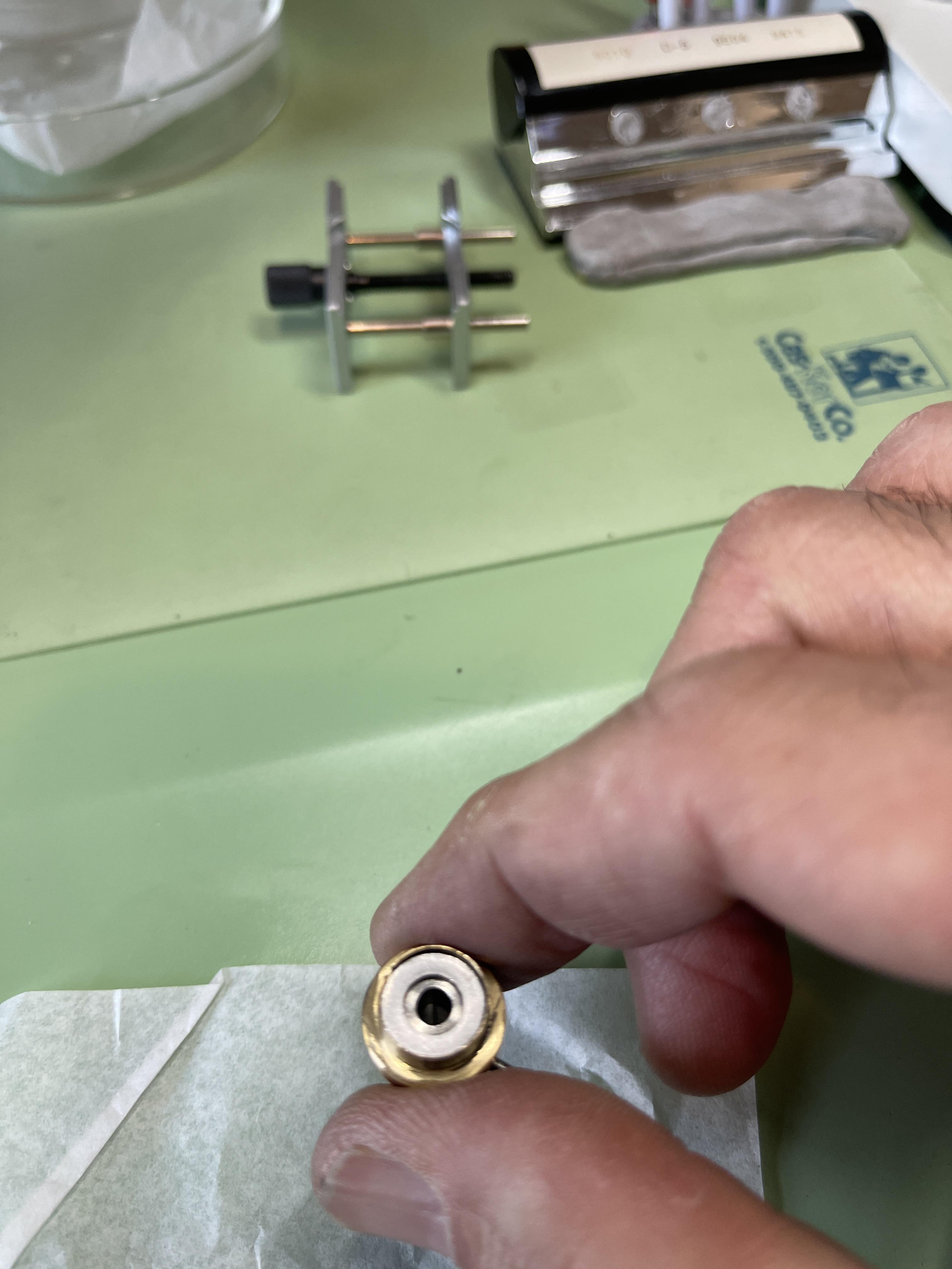

I made a couple of winders for Seiko mainsprings.  I didn't feel like trying to sort out all the details of which bergeon to buy, or taking a chance on a chineses set.  The one shown here is for 70xx series movements.  It's not a thing of beauty, but it works pretty much 100% of the time if I do it properly.  Looking at the photo reminds me how I should get a nicer knurling tool!
The housing and plunger are acetal, the arbor is brass.  I also have one for 61xx series barrels.  The only difficult part was making the hook on the arbor.  The rest is really just standard lathe work.
