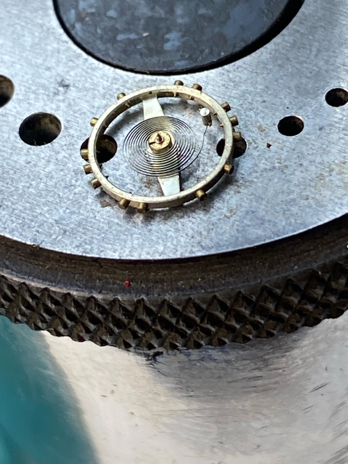

A need help here my index pins keeps touching my hairspring I can't seem to get right very frustrating does anyone have a answer for this?
When you say index pins do you mean the regulator pins? I would like to see the balance attached to the cock in the movement nice clear photos please.
Yes a mean the index pins ok when am home a will take more pictures put the balance to the cock and send more pictures
