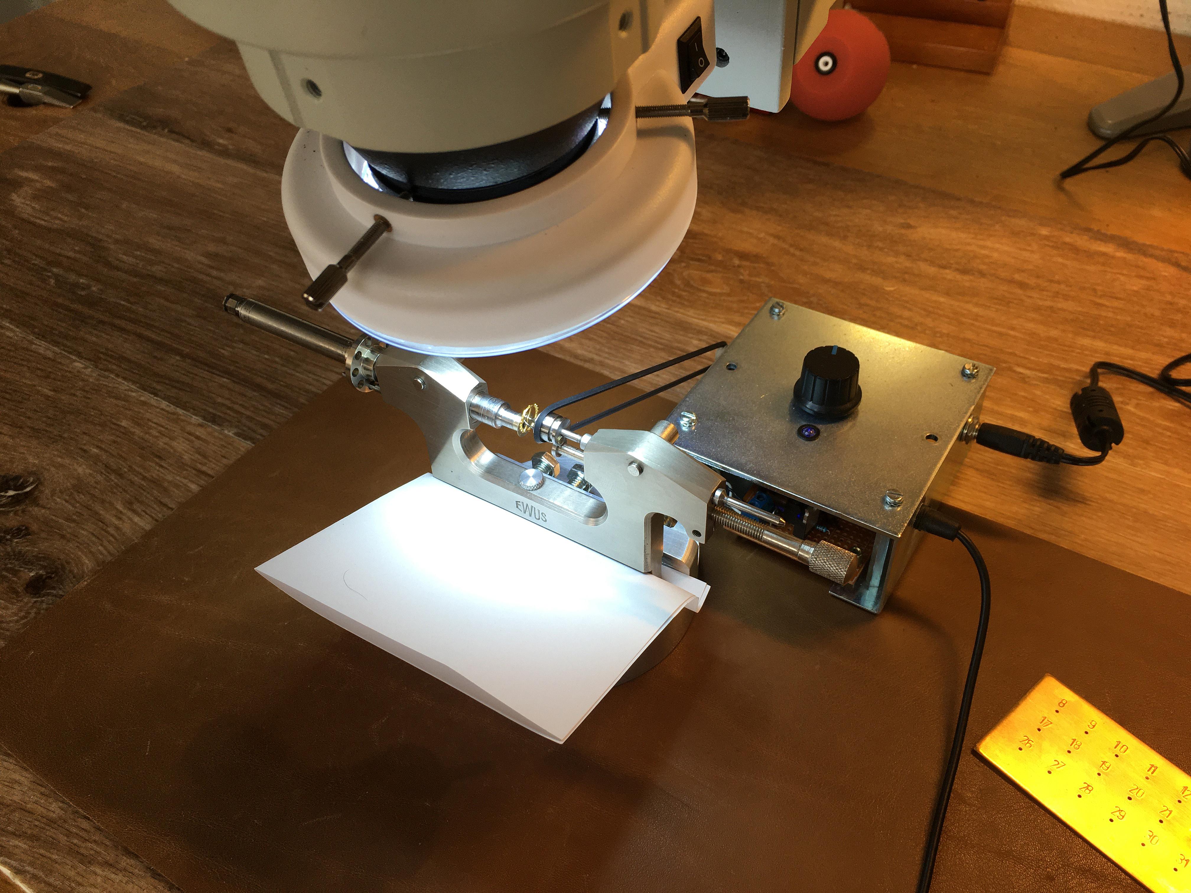

In connection with the interesting current balance riveting discussion (https://www.watchrepairtalk.com/topic/28854-new-balance-staff-not-riveting-to-balance/#comment-243895 ), I like to bounce off my "one-off" or "emergency lathe" idea.
I too need to change out a balance staff, this time from a Valjoux 5 chronograph movement.
I've done successfully a balance staff change out before, but on hindsight I wasn't too happy with the way I did it and nearly screwed up the hole in balance-wheel.
Not having a lathe, I could knock the staff out using my staking tool or perhaps use Alum (potassium aluminum sulfate) to de-solve the balance-staff.
While polishing the screw-heads of a nearly finished Le Phare 114CVV chronograph pocket watch, the idea came to me to convert my screw-head polishing tool into a "one-off" or "emergency"-lathe to remove the balance staff rivet-rim.
As some of you may know, I made a variable-speed belt-drive for my Jacot tool;
Using the same setup with my screw-head polishing-tool give this;
With the handle-bearings well oiled, the motor drives the handle very nicely. The two "runners" in front of the tool can be adjusted in height and would double as a nice support for a cutter.
Now I know, there are some "problems", one of them being is that the handle is laying loose in the bearings and could potentially lift-up when the cutting forces are becoming too high. I discovered that, next to the weight of the handle, proper oiling seems to additionally "suck" the handle into the bearings. Also the positioning / angle of the bit will become critical.
But how much force is developed / needed when cutting a balance staff rivet-rim? Also nobody says that the rim has to be cut within 1/2 minute and of course the cutter has the be sharp.
To me there are another advantages, if this were to work for "light" lathe work.
I do already own the polishing-tool and the tool comes with a nice selection of chucks, suitable for nearly all watch balance-staff dimensions and other small items
and I do have already a nice variable-speed belt-drive for it.
Obviously I like this idea to succeed.
Any of you some suggestion on  how to improve on this idea?

As said, nobody said that the rivet ring has to be cut within 1/2 minute. I was planning to cut in small increments. Even if I were to manage to weaken the rivet-ring, that would already be an improvement compared to banging the whole thing through the balance-wheel.

If the screw head polishing tool was raised above the drive the belt would be pulling down on the shaft, helping to keep it in place.  A plastic sheet could be cut, lightly greased and held against the shaft with elastic, a temporary crude bearing.
That is going to be a bit problematic since the driving unit is light in weight and currently free standing. However, the front bearing of the polishing tool has a recess-groove and since the belt is pulling sideways, the rotating handle is a kind of "secured" sideways. Most likely, it's when the upwards force is higher than the "suction-force" of the oil, the weight of the rotating handle and the "locking-force" of the sideways pull in the groove, that the handle may become "unstable". But to my mind, to archive that force, compared to the size of the rivet-rim, the cutter has to really "dig-in"  ...... 🤔

Hello, I'm new here.  I like the idea, but use an old balance from a junk/parts watch to test it out.  I'm of the impression that the idea will work well, as long as it runs true enough.
