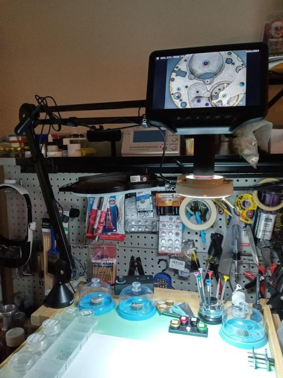

Hey guys,
So I am very new to watchmaking and I bought the microscopic camera, which can be clamped to the table, and then you connect it to a PC. This in total with the laptop I will connect it to will be around $230 in total.
Here is a photo of the current setup:
Now, I saw another option, which is a microscopic camera with a base attached to its built-in screen and it is like $70. So it is comparatively like a third of the price, so I am wondering if that's a better option.
Link: https://www.amazon.com/gp/product/B0CBV43XXR/ref=ox_sc_saved_image_1?smid=A25KB8OA370XBE&psc=1
The only downside would be I will not be able to work on the movements directly under it since its base is very small.
My purpose for recording is to have some record of taking movements apart when I get lost while putting them back together.
What would be my best option?
Thanks!
I use a similar setup using a Adonstar microscope from Amazon (similar to your link) removed from it's table mount. I attached it to a microphone boom arm with a 3D printed bracket. It stays above the bench and when I need it to take photos, I pull it down. It makes it easy to document a disassembly. The nice thing about the microphone boom is that it stays where you place it. I also added a light source.
Oh i didnt know that you can remove it from its table mount! Thats incredibly useful, I think that might just be my best option! I have the mount and the lights also, so I might just return the Hayear camera I got and get one with the screen and dismount it from its table and use it on my mount! Thanks!

Yes i totally agree, hence I wanted the screen as well, but I just dont like the small bas which I cant do much on other than take a photo... This is why I think @JackH solution is really good!
