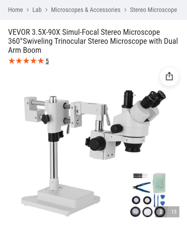

It's also helpful to have the ability to film or photograph what you are working on so a microscope with a simulfocus trinocular port may be something to consider.
I use a loupe but do have/use a boom arm  Amscope brand scope,[ WF 10X/20 ] eyepiece, and add a 0.5x Barlow lens for depth/working abilities, probably a little more than the one you are looking at....the one you are looking at will work for inspection purposes though....
On 4/1/2024 at 5:41 PM, Bonefixer said:
Is Vevor an Amscope copycat, looks much the same
It seems that most of these models are from the same (Chinese) factory, just differently branded & priced. Mine Chinese scope is branded as a "Swift", but there is also Euromex, Besser, Bewinner etc etc. All suspiciously similar looking.
I think Amscope stands for America scope, a catchy brand name for in the US and mostly sold in ...... you guessed it; the US. The same scope for in the EU is branded; Euromex.
