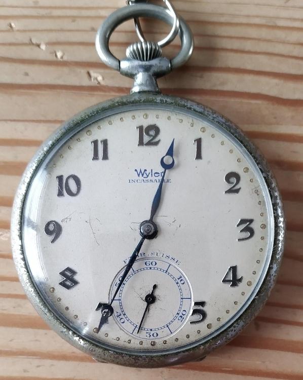

Hello,
Could someone help me to identify this movement? It comes from a Wyler pocket watch, but the only thing I know is that it's an Incaflex.
Many thanks!

The size is 36mm or 1.42 inches. That seems to be equal to 16 lines, but what is the exact name of that caliber? I will have to find an escape wheel for that movement, but I can't find any reference to a Wyler 16.
When I was looking earlier on, I did find a "Wyler 16" movement, but it is very different to yours. In the article it said that one was the only fully in-house Wyler movement?
That implies yours is based on another makers movement, with Wylers customisation, but I cannot find any with the same keyless details so far.. That yoke is strange and distinctive!

You're right : it seems that Wyler has used ETA and AS movements and modified them. I will continue searching which one could be mine.

if you scroll down the page far enough you'll see a reference to Wyler 17. Because of the age it's too early for the bestfit book and even another book I looked at the 50s didn't have it listed.
https://uhrforum.de/threads/wyler-incassable-ca-1935-aussen-bauhaus-stilikone-innen-technisch-eigenwillig.383435/
It's looks exactly like my movement! The link you mentionned is in german, but I understand that nobody is sure about the fact that Wyler created that calibre. It might be another manufacturer's movement which has been modified. So finding the right escape wheel will be miraculous.

This 16 lin. is the only movement showing up in the books - a good evidence it is a genuine Wyler, not relabelled.
The name? „Wyler 16 lin.“ 😀
