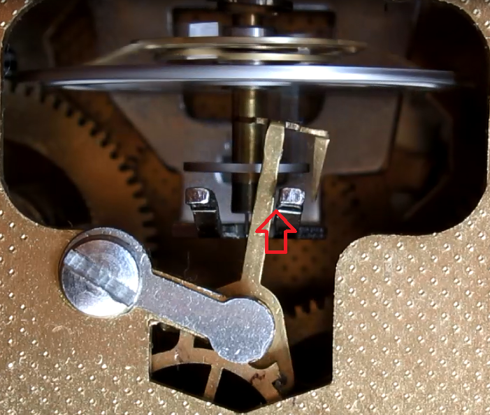

Have a 1976 Hermle 340-020. It ran for maybe 10 years back then and then stopped. It sat unused until a few months ago when I decided to look into getting it running again. I cleaned the pivot points and oiled them. Then cleaned the escapement with a artist brush and a solvent. Then oiled it. The clock is now running.
 However, I have been tracking its accuracy. What I see is that after winding it runs fast but slows as the days go by. For example.

Is this normal? If not, what could be causing this drop off in regulation?
Thanks
Hi welcome to the forum. The issue you are experiencing with the clock is typical of a clock that needs servicing with a high probability that bushes need replacing. When fully wound this issue is overcome but as the mainspring unwinds there is less power and the clock slows.Looking at the barrel barrel bushes would be a good starting point

You mentioned the guard pin. Is this the pin you are referring too? If so, are you concerned about it hitting what is the safety roller in the diagram 2?

Yes, the guard pin and safety roller are what is shown and they would never touch when the balance swings. If they touch, this leads to friction and amplitude loss.
Yes, the gap with the arrow is 0 and it is a real problem, but it is true only when the string is in horizontal position, and I believe that the picture has been taken exactly in such position. In vertical position, which is normal for the balance, the mass of the balance wheel must straighten the hairspring in a manner that the balance will hang on the spring and neither the bottom of the tube, nor it's top will touch the limits. This is easy to check - try to lift or lower the balance along the string and You must see that it is possible and actually it hangs on the spring...

In the vertical position, the balance wheel was not floating. It was sitting on the bottom of the frame. I adjusted the lower spring collet and got it floating. It easily passed the 270 degree 3 to 5 minute oscillation test. It took 8 minutes for the wheel to completely stop moving.
I put it the unit back in the movement and checked the safety pin. It does not touch the safety roller anywhere in +/-270 degrees rotation from neutral position.
But the amplitude of the rotation with the spring fully wound is weak based on what you are saying. It rotates +/-90 degrees from the neutral position.

However, I have noticed the banking posts are not controlling the lever position on the right side.  I may have some work to do here.
From the photo the pallet arm looks as if it has been tampered with the edges are not nice and straight this can cause problems on the banking pins.
